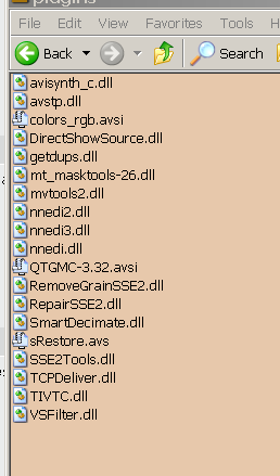

    Here's my AVISynth plugins folder list:
Name:	AVISynth Plugins.png

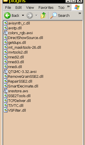

    Yes, here's my plugins folder once again, just in case something's amiss:
  18. Apparently QTGMC is autoloading on your system. So try renaming SRestore.AVS to SRestore.AVSI, removing the import line in your script, and see if it autoloads.
