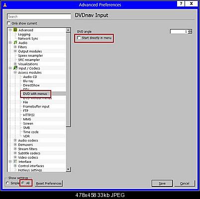

  3. Not a mac user and no idea how you authored the DVD but if you use any commands in the first play domain notice that VLC defaults to start directly in menu.

    I finally had time to test this again. MPlayerX mirrors the Mac DVD player and plays form the beginning.
    Checking the box for "No DVD Menu" in VLC solves the problem. I don't know why VLC does this but I've had the same problem every time I edit in ways I described in the OP.
