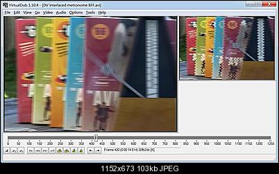

  7. Since the video was resized vertically and not treated as interlaced it is not possible to cleanly separate the two fields any more. About all you can do is blend what's left of them together.
  8. Much better. I don't expect miracles.

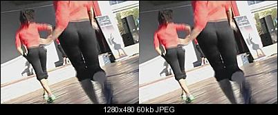

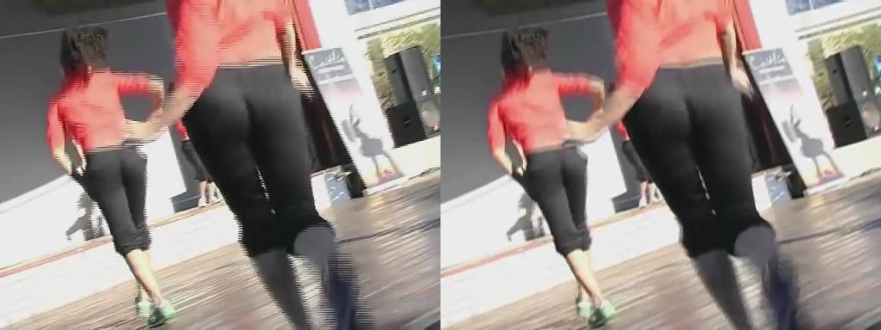

  9. But on some points I get this with linear blending:
    Maybe due to different sources of the clip?
  10. That's an artifact from re-sizing without first deinterlacing.

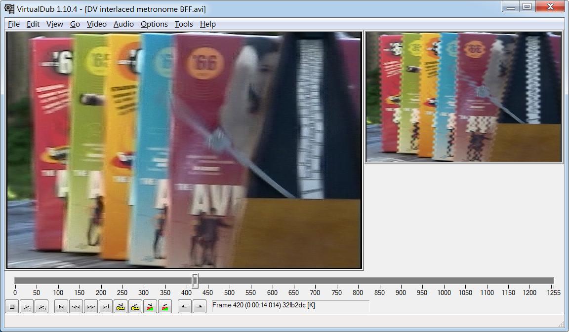

    You get that from a simple bilinear or bicubic filter and a clean interlaced source. VirtualDub's simple bicubic resize filter:
    I downloaded the video from youtube assuming it was your source. You have a better source? Why didn't you provide that instead? If you have a good clean interlaced source use QTGMC().

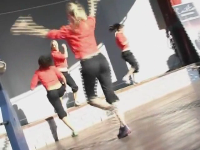

  12. I don't have another source. I downloaded the highest resolution from youtube. The Problem is that some scenes are "fine" but other scenes look like this. I think at least two cameras were used. One was set to Interlaced, the other not or this source was deinterlaced already. What can I do to get rid of the horizontal artifacts of an kind? These are very annoying.
