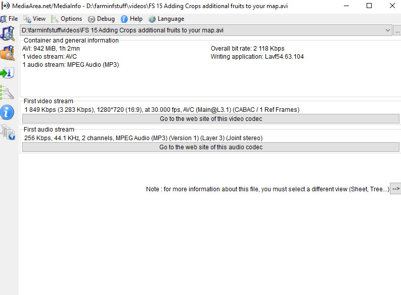

    I have a short video clip .avi but the volume on it is very low, what tools do i use to extract audio then what tool to increase volume, then how do i join audio back to video again

    Extract the audio with for example Virtualdubmod(under Streams) or Pazera Free Audio Extractor.
    Increase the volume in for example audacity, goldwave, etc. Save as a new mp3.
    Multiplex back the video with new audio with virtualdubmod.
    Or use Xmedia recode, open avi, choose Format: avi, under the Video tab choose Mode: Copy, under the Audio tab choose Codec: MP3, Volume Correction, Volume change(%) and try 150, click Add to Queue and last Encode!
