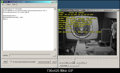

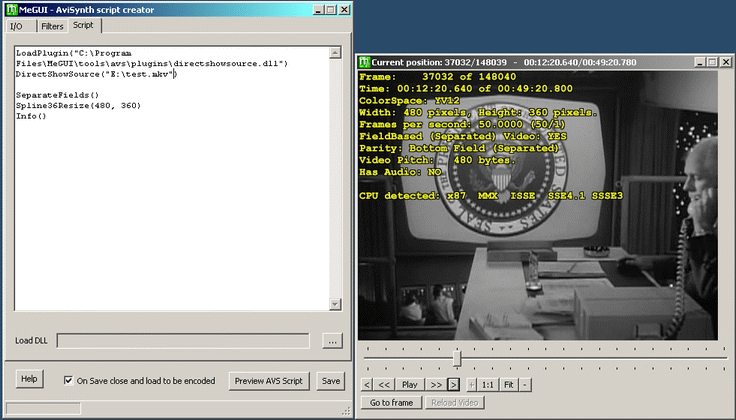

    Have you used MeGUI at all? You can use the File/Open menu to open a video, MeGUI will offer to index it. Run the indexing job and the script creator will open with a preview. Switch to the Script tab. Type the following below what's already there and refresh the preview. You can freely navigate backwards and forwards.
    SeparateFields()
    That'll probably halve the video height. If you want to go back to full height, try this (substitute the original video width for "A" and the original video height for "B". The info line was added to provide basic information.
    SeparateFields()
    Spline36Resize(A, B)
    Info()
    Avisynth assumes bottom field first if the field order can't be determined, but to tell it bottom field first:
    AssumeBFF()
    SeparateFields()
    Or tell it top field first if need be.
    AssumeTFF()
    SeparateFields()
