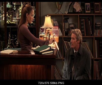

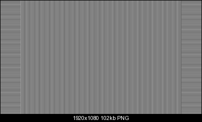

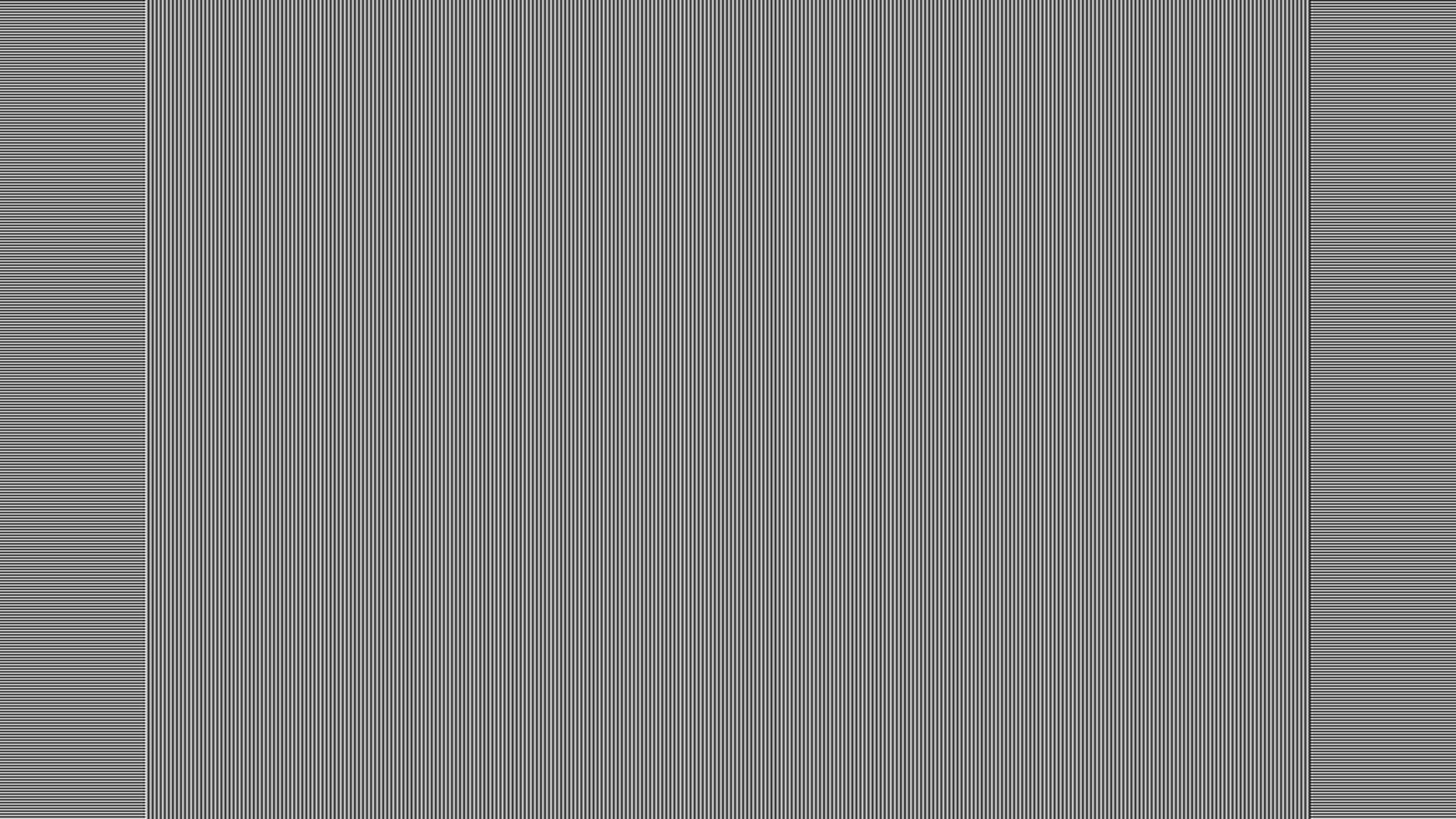

  3. Originally Posted by hello_hello View Post
    I gave it to Irfanview to upscale as a quick test. Lanzcos resizing.
    Resized directly from 720x576 to 1920x1080
    Resized in two steps. 720x576 to 1024x576, then 1024x576 to 1920x1080
    It just so happens that Lanczos works well at the 1024 intermediate. BlackmanResize() too. If you had used Spline36Resize() you would have seen this:
    Most other resizers give moire artifacts similar to Spline36. And they all give similar artifacts at NTSC's intermediate of ~852x480.

  6. Originally Posted by Hmmm View Post
    According to HandBrake's own website, it says it is a safe option to leave decomb on at all times.
    You should always disable filters your source doesn't need.

  8. Originally Posted by jagabo View Post
    I understand the concept and in a perfect world.... one where nobody ever makes a god awful movie based on Marvel Comic characters (I tried to sit through one tonight and I take my hat off to anyone who can).... you probably wouldn't resize, but while I'm fully aware doing so can cause unwanted side effects, I'm still not convinced the sky will fall.
    I'm not arguing with the result of resizing your picture. I expected it. I'm still not sure how often you'd be resizing something similar in DVD video, or if you were, if it'd already be a mess. Many times I've noticed excessive haloing somewhere, or a moire effect etc, but checking usually reveals the problem is already present in the source video.
    Anyway..... the $2 question remains..... so I'll try a third time. Of the two screenshots I posted, which looks better to you? Because I've owned my Samsung TV for about four and a half years now, and I've encoded many a DVD during that time, always resizing to square pixels, often resizing the height a little also, and I'm still confident the resized encodes tend to look better.
    Since rethinking my outlook on the world and the shape of it's pixels, I've mentioned my thoughts here and there and the error of my ways are explained, and I generally ask for, but so far haven't received, a real world example of DVD video that suffers as much when stretched to 16:9 as it can in theory. Even half as much would do to begin with.....
  9. Originally Posted by hello_hello View Post
    I prefer the one that went directly from 720x576 to 1920x1080*. Most TVs and DVD players I've seen use a bicubic filter to upscale so the result would be a little sharper. And the square pixel version would have its oversharpening halos further exacerbated.
    * Though it might depend on the viewing conditions. If you're sitting far enough away the oversharpening halos aren't really visible, the picture just looks sharper.
    So you prefer the first one based on how you think it might be processed and not based on how they look?
    One the other side of that coin, it's fairly common for TVs to have built in noise removal and deblocking enabled by default which blurs the picture as a result.
    But yes, I agree. On occasion, if I switch MPC-HC to bicubic upscaling, sometimes it can look borderline over- sharpened, but mostly if the DVD picture has already been sharpened and I tend not to using bicubic anyway. I prefer softer upscaling for the lower end of the viewing quality spectrum (ie low resolution Xvid encodes) and I can leave it that way for the square pixel DVD encodes because they've already been sharpened a little, and for 1080p it doesn't matter. I'll confess I do tend to give more weight to how it'll look when viewed with my equipped than I do to how it'll look when I'm not viewing it on something elses.
    To be honest, I'm not even sure that sample is typical. It was just one I had handy to demonstrate the difference, and looking again I think it was a bad choice.

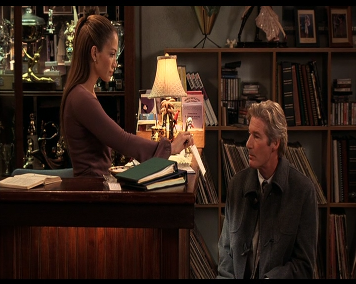

    This is a MPC-HC screenshot from the anamorphic encode. No resizing anywhere. A minute or so in time earlier than the previous screenshot. What's your opinion? I think I might have picked an already sharpened video to use for the comparison. If so it wasn't one of my more clever moments. Does it look sharpened to you?
    I think it's a sharper than average. But not over done.

    Co-incidentally, I'd use almost those exact words to describe the result of spline36 stretching the width to a 16:9 resolution for encoding. Assuming, of course, the DVD isn't too much sharper than average to being with.

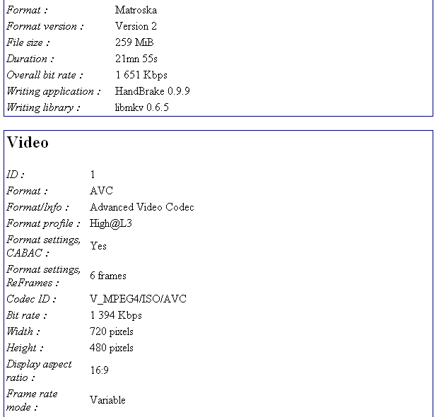

    Would I be interpreting the following correctly?
    https://trac.handbrake.fr/wiki/Telecine#vfr-in-hb
    "Even if a source is entirely hard telecined, HandBrake's detelecining filter is stateless, and will produce variable output: if part of a scene has no movement, it won't detect any telecining since there will never be any combing, even in duplicate frames."
    Wouldn't that be the definition of not detelecining?
    I'm having trouble wrapping me head around that one, given I've spent most of my life believing the detelecine process always applies telecine removal.
    The Handbrake detelicine process doesn't care about the frame rate, so if need be Handbrake "fixes" the frame rate according to what was specified. Therefore if you specify a constant 23.976fps for a purely telecined source, there might be places where the telecine filter is outputting up to 29.970fps and Handbrake discards as many as required for 23.976. Is it just because I'm very tired, or does that seem to icrease the potential for ugliness somewhat considerably?
    Re-reading the earlier description of Handbrake's detelecine filter:
    https://trac.handbrake.fr/wiki/Telecine#detelecine
    When there's an obvious 3:2 pulldown pattern the detelecine filter outputs 29.979fps progressive where one in five frames is repeated. That seems familiar. Handbrake prefers not to keep duplicate frames, but if you tell it to output 29.970fps it will. Not ideal though. If you specify 23.976fps it'll drop one frame in five, and you'd have to assume the duplicates would be the first to go.
    If you just leave the framerate as "Same as source," though, HandBrake will drop those duplicate frames and only those duplicate frames, with no extra dropping or copying of frames. We call this process Variable Frame Rate detelecine.
    Sorry, I'm really thinking out load as I type, trying to get it straight in my head.
    Is the end result of Handbrak's IVTC going to be typical IVTC?
    We know the detelicine filter's output is 29.970fps if there's a steady 3:2 pull-down pattern.. We know if you tell Handbrake you want a "same as source" variable frame rate output it varies the frame rate by dropping duplicate frames. There's no mention of a frame rate reduction as such, or of the frame rate being averaging etc, only the dropping of duplicate frames. Therefore wouldn't the output still be 29.970fps progressive with the duplicate frames dropped rather than encoded, but still 29.970fps with one frame in five effectively repeated. Is it really?
    Over the years I've seen a reasonable amount of Handbrake DVD encodes, and generally assumed some sort of user error..... so I searched the archives and found this:

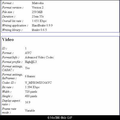

    MPC-HC says it's 29.970fps, despite the fact Reclock immediately contradicts it and claims 23.976fps.

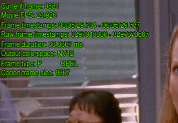

    So I invited ffdshow to the party. It's displaying a very steady frame duration of 33.3367ms which would be 29.970fps which it contradicts itself by displaying a frame rate that mostly wanders between about 23 and 24fps
    It does give a reasonable indication there's effectively "missing" frames though. I started the frame count at 18040 and stepping through them one at a time caused ffdshow to display this sequence (there was steady movement).
    18040, 18041, 18042, 18044, 18045, 18046, 18047., 18049, 18050.
    At the other end of the encode, where there was nothing to see but static credits, ffdshow indicated all the frames were present and a fairly steady 29.970fps frame rate. Reclock was still claiming 23.976fps.
    I thought I'd mention I tried a quick re-encode of the above encode and ffms2 output was not a typical frame rate and motion wasn't the smoothest, but if I told ffm2 to convert the frame rate and output a constant 29.970fps, and if I followed that with tfm().tdecimate() the output looked nice and smooth at 23.976fps.
    I'm not sure if I'm missing the obvious or if Handbrake's detelecine works quite differently to what I expected. I've had enough for tonight though and I do need to catch up one some sleep. Comments would be welcome.

  17. I'm still not sure what's going on with ffdshow but I managed to fix it's schizophrenia. I'd set it to decode so I could use the on screen display but today I enabled it's raw video decoder instead so it'd just process the LAV output. That way things made sense. The frame rate being displayed matched the frame durations.
    What I'm seeing now is a combination of two constant frame rates. The output is either 23.976 (where there's motion) or 29.970 (where there's no motion). Nothing in between. I thought variable meant "any frame rate" but maybe when you encode NTSC and specify "same as source", Handbrake effectively switches between 23.976 or 29.970 as required. Which probably seems odd if you're encoding something that's pure "film" from beginning to end, but if that's the compromise needed for Handbrake to encode a combination of "film" and "video" correctly, rather than have to convert one to a common frame rate, maybe it's not a bad thing, especially if Handbrake's equivalent of "force film" is to simply set the output frame rate to a constant 23.976fps.
    I'm sure for the sample I looked at, that's what's going on. A combination of two constant frame rates. There's still a few things I'm not sure of though, such as what's the difference between "same as source, constant frame rate" and "same as source, variable frame rate". I suspect for the former you get a constant 29.970fps and any "film" sections have one in five frame repeated, because I'm sure seen lots of Handbrake NTSC encodes like that.
