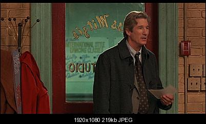

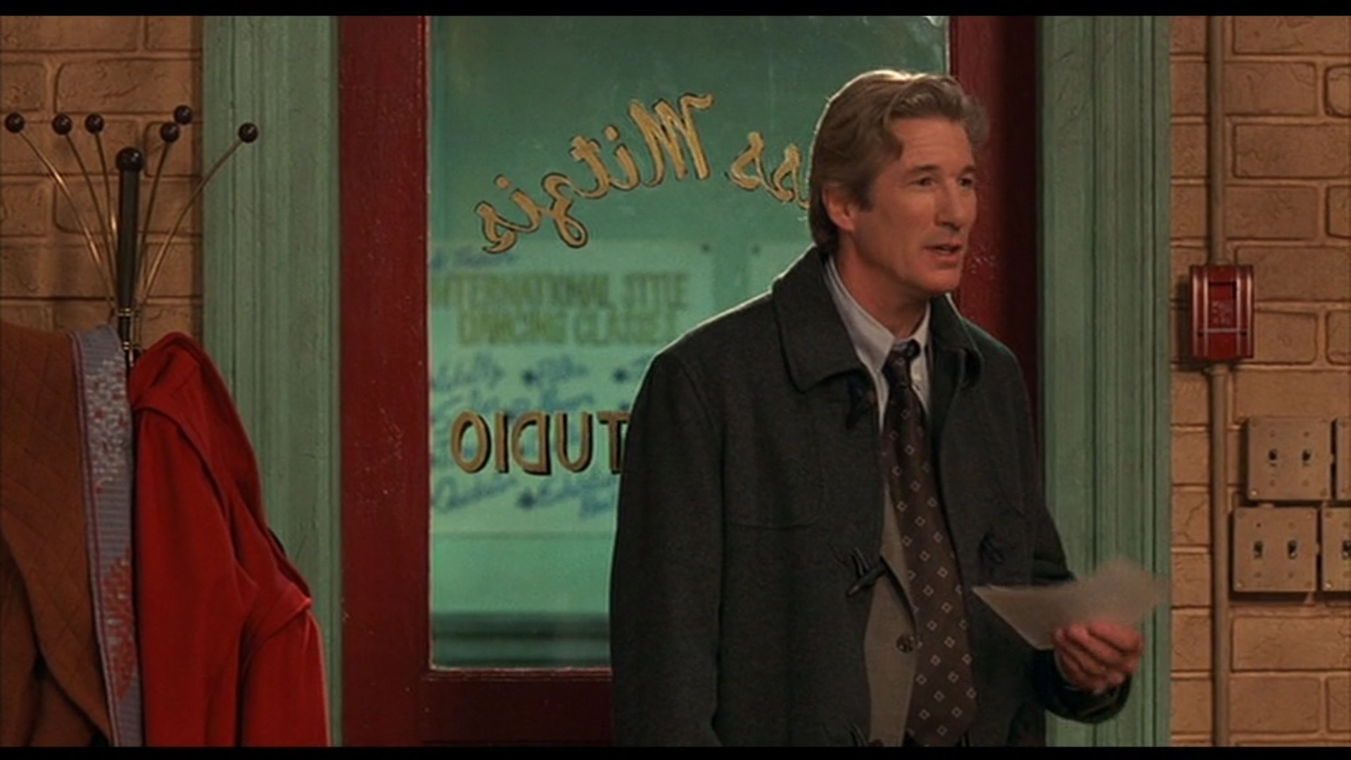

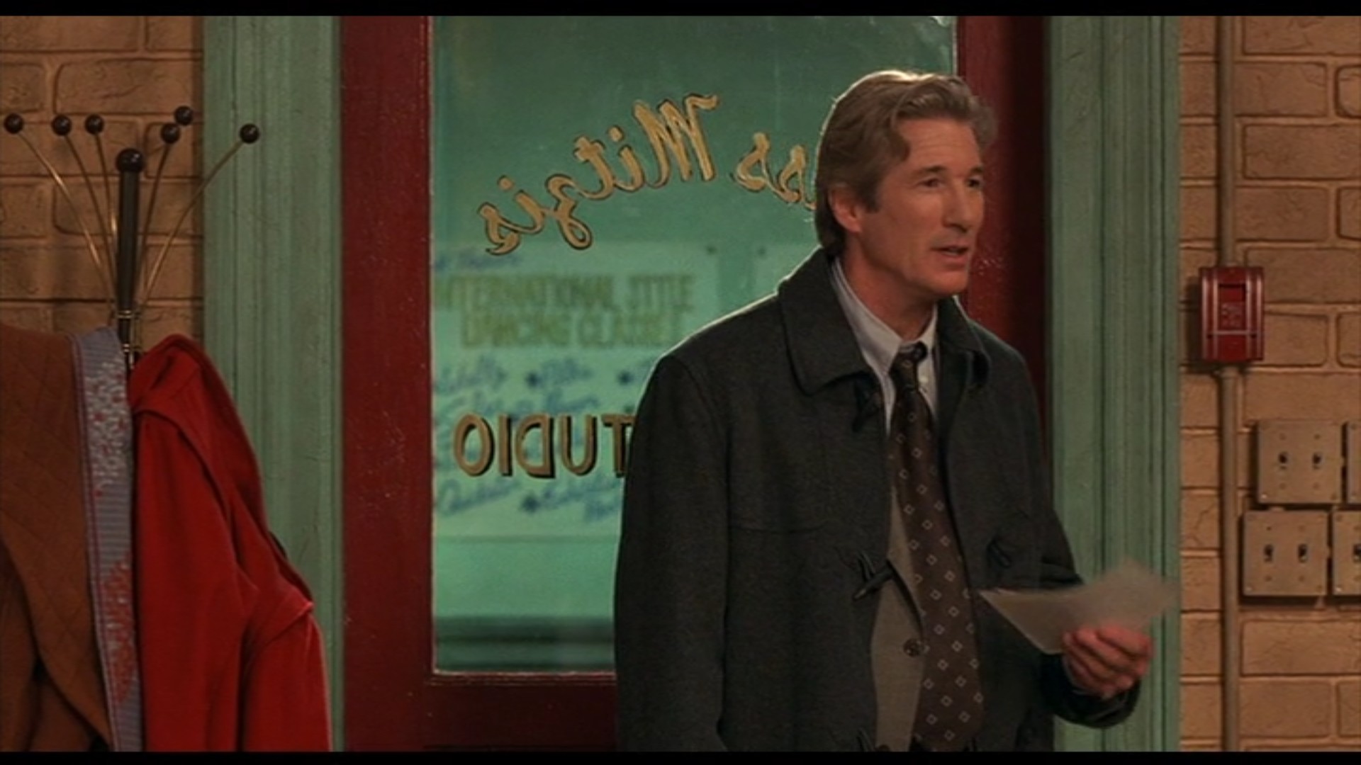

    All resizing introduces artifacts. Avoid resizing when possible and only crop.
    My theory is a DVDs are invariably going to be resized on playback, very likely upscaled to 1080p, sometimes to 4k, so in the over-all scheme of things....
    DVD quality isn't anything to get excited about anyway and in my case the TV in the living room has an aspect ratio ignorant media player so I resize to square pixels. I think of it as giving the resizing a head-start.
    Seriously though..... I've compared anamorphic DVD encodes to resized DVD encodes and the DVD video itself, and if I resize a 16:9 PAL DVD to 1024x576 (although 960x540 usually works just as well) I think it looks better than an anamorphic encode when running full screen, and mostly looks better than the original DVD itself.
    Two screenshots of DVD encodes running fullscreen on my TV. Same MPC-HC bilinear upscaling, no filtering during encoding, same encoder settings..... the only difference is spline36 resized the second one to 1024x576 when it was encoded. Am I wrong to prefer it? Actually, if I am don't tell me. I think I'd prefer to continue enjoying my own ignorance....

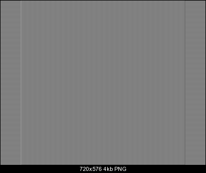

  20. Originally Posted by hello_hello View Post

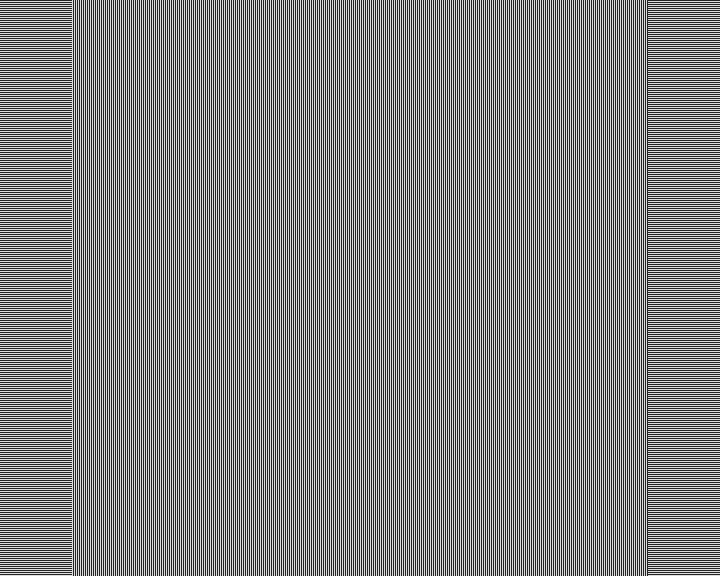

    My theory is a DVDs are invariably going to be resized on playback, very likely upscaled to 1080p... so I resize to square pixels. I think of it as giving the resizing a head-start.
    I see that as all the more reason not to resize before encoding. One resize is better than two.
    That's because you used a sharper resize algorithm in your square pixel encoding. So you've handicapped the player's scaling. And actually, if you look closely at your square pixel encoding you'll see it has introduced oversharpening halos. They are mild but what if your player had used a sharper upscaler? The halos would get worse. And there are some cases where the intermediate resize, regardless of what filter you use, will show obvious moire artifacts. Try the same comparison with this image:
    That's a degenerate case, of course. But you sometimes see elements that look like that in videos. Vertical blinds in the background, lines on the side of a skyscraper, striped pants on an actor, etc.

  23. Originally Posted by jagabo View Post
    I don't quite follow the "handicapped the player's scaling" comment.
    I'll have a look but I'm not sure there was a lot of halo creating going on. I think the resizing sharpened the existing halos, or made them more noticeable, however you might describe it.
    Here's another way to look at it.....
    Most of us have applied noise filtering at some stage despite the fact it blurs to some degree, and we've all de-interlaced even though there's no perfect way to do it. Is there a video filter that only has a positive effect? No adverse effects at all? So assuming resizing is just like any other filtering in that respect.....
    Obviously you can look at the screenshot and find some adverse effects, but that aside, which picture do you prefer?
    I'm not sure your image is a good example in this case, as it's not anamorphic, so it wouldn't compare apple resizing with apple resizing. I'll confess I often throw caution to the wind and resize the height to some degree, but that's something else again. Do you have an anamorphic picture I can un-squish to see what it'll look like?
    There's definitely been one occasion where after encoding I thought "well, that's not good" but it wasn't all my fault. Someone else decided to sharpen the "Analyse That" picture for the PAL DVD a little too much and it snowballed from there. I gave the encoded video to my sister to watch, which she did using her Samsung Bluray player, which upscales just a little too sharply for my taste, and when I walked into her room while she was in the middle of watching it my immediate thought was "I guess I'll be doing that one again".
    For me though, stretching the width results in more happy than sad 99% of the time, otherwise I'd find a way to avoid it.

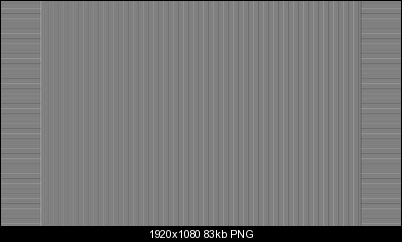

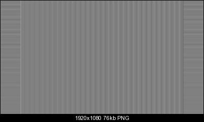

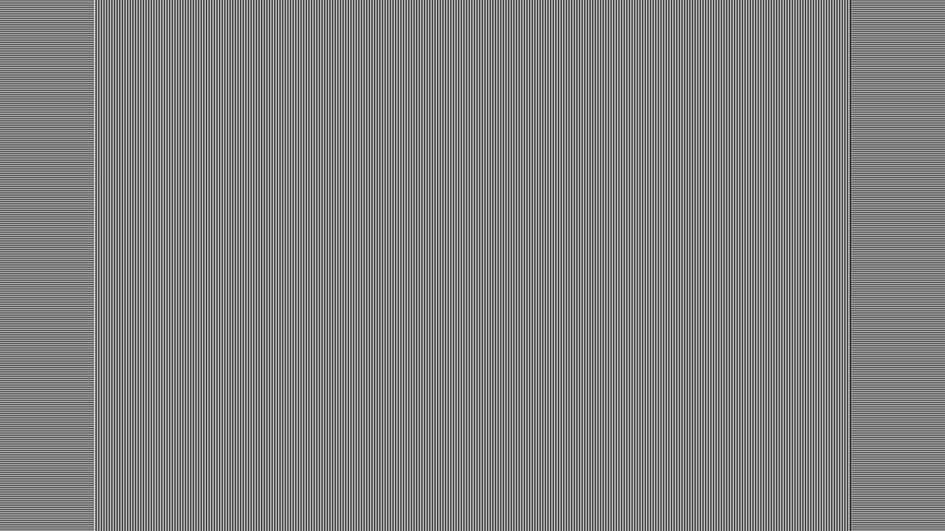

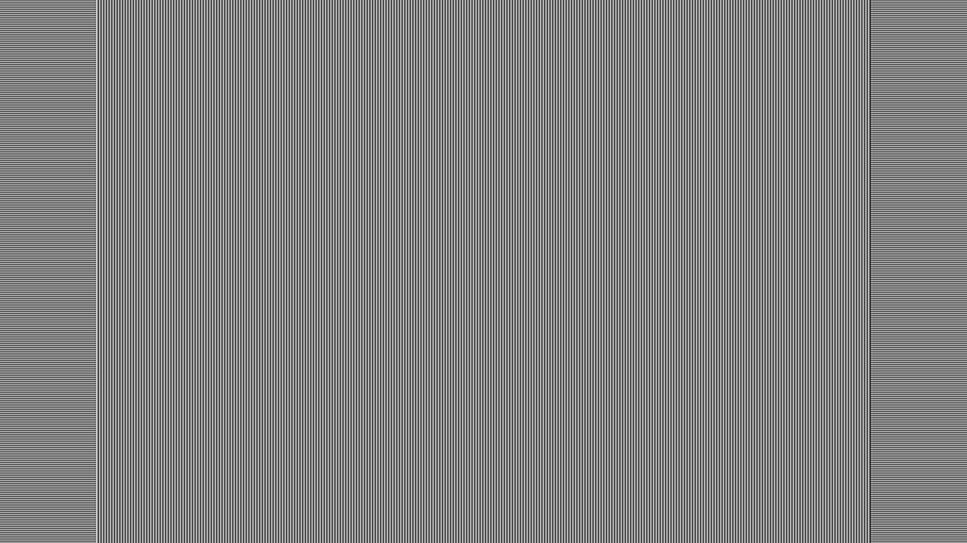

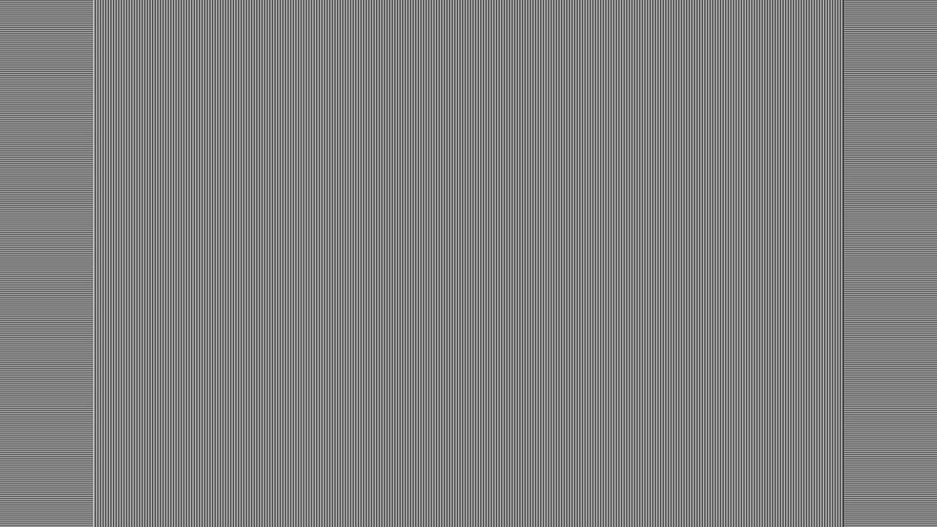

  25. Originally Posted by hello_hello View Post
    It's just a 720x576 image. It's anamorphic if I say it's anamorphic. It's anamorphic if you treat it as anamorphic. You can treat it exactly the same way you treat a 16:9 DAR MPEG 2 video.
  26. I gave it to Irfanview to upscale as a quick test. Lanzcos resizing.
    Resized directly from 720x576 to 1920x1080
    Resized in two steps. 720x576 to 1024x576, then 1024x576 to 1920x1080
    Edit: I meant to include this one with the other two but got distracted. It's a PAL resizing I tend to use a fair bit.
    720x576 to 960x540, then 960x540 to 1920x1080
    The result was pretty much as I thought it'd be. Too be honest, maybe not as bad as I expected, but obviously messing with the height isn't ideal. Mind you thinking about it, most video that finds it's way to DVD these days would start off at a higher resolution, downscaled and anamorphically squished, possibly sharpened, maybe edge enhanced, encoded with a less than ideal bitrate.... what's the odds of fine detail surviving the process so I can mess it up?
