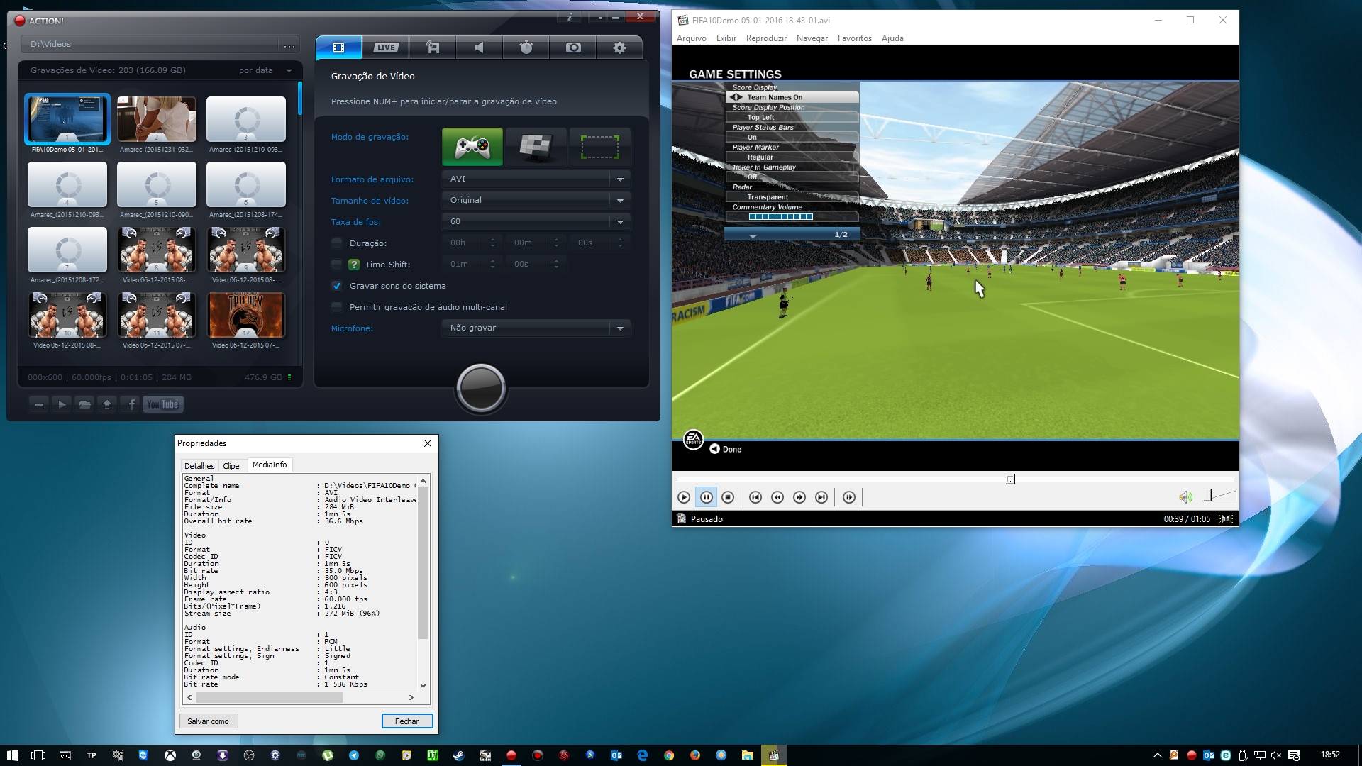

    Hi supercain,
    After some tests I can say that the problem is on your computer, it works with any Capture Software.
    I use Mirillis Action and Bandicam. Both worked perfectly on Windows 10 Pro X64. Look:
    MIRILLIS ACTION!
    BANDICAM
    Tip: Update all computer's drivers (video, audio, chipset)
    Any doubt, call me.
    Claudio
