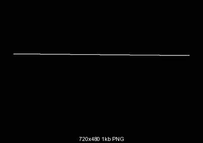

    But after a simple bob some edges bounce up while others bounce down between frames. For example, here's a still, near horizontal line:

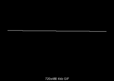

    And after a simple Bob() in AviSynth (slowed to 2 fps for clarity):
    Some parts of the line move up, other parts down, between frames. So you can't just shift a field up or down.
