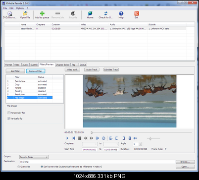

  1. Happy NY guys. Sometimes when I record using my phone and when I transfer the video to my computer, the video is either 90 degrees off or upside down. Is there a free, easy to use, program that can transpose or flip the video 90 or 180 degrees?
    You can rotate/flip mov files with Quicktime pro without reconverting.

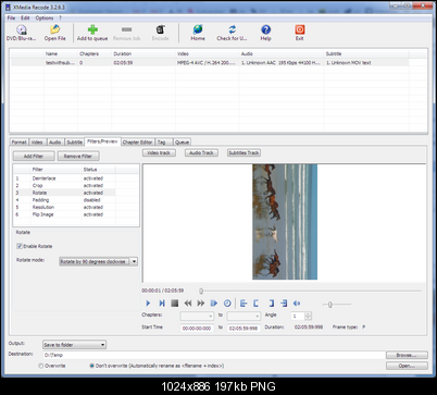

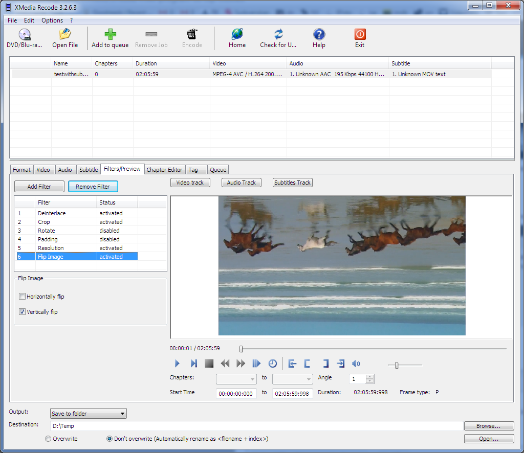

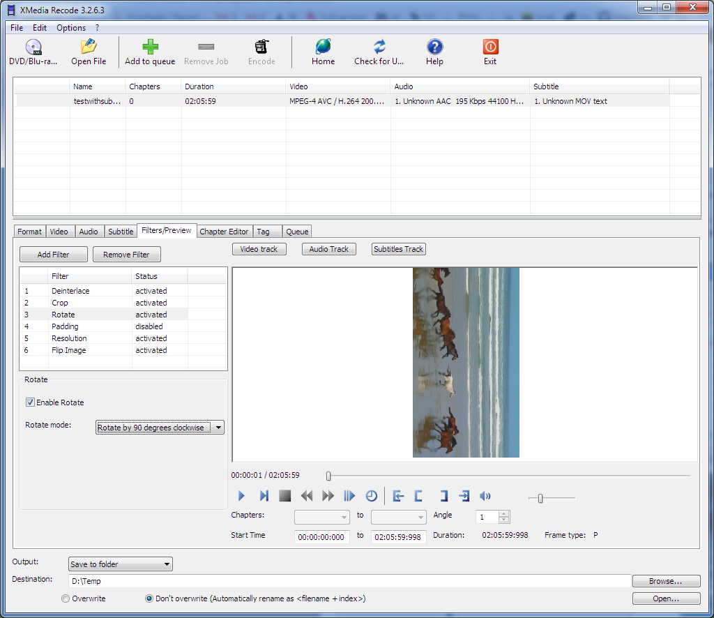

    For any other format use for example Xmedia Recode, Open File, choose Format: Custom, Format: MP4 (for example), under Filters/Preview add the Flip Image filter, click on it, Vertically Flip, Add to Queue and last hit Encode. If you want to rotate 90 degrees add the Rotate filter.

  3. Thanks Baldrick. Is there anyway to keep the same quality? XMedia Recode flip the mov file vertically, but downsized the original movie from 100 mb to 7 mb. I changed the format from "3GPP" to "MOV" (thinking that was the issue) but the finished file has flashes of green on the bottom half of the video. Not sure why it does that. Codec = MPEG-4
    I changed the framerate from 15 to "keep original" and thought maybe that would keep the original quality and size but it didn't. Still only 7mb from 100 mb.
    What is the difference in bitrate? It is currently set at "average bitrate" but you can change it to "2 pass average bitrate" and "constant quantizer" When you change it to the last one, it changes the value from 2000 bitrate to 65567 quantity.
    Constant or Average Bitrate = 2000 (should I change it? I have no idea what is optimal)
    Constant quantizer = 5 (should I change it? I have no idea what is optimal)
    GOP length = 25 (should I change it? I have no idea what this is)
