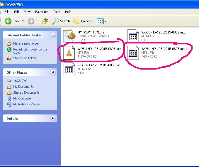

  1. I have the Ematic Digital TV Recorder. If you record to a USB memory stick that is fat 32, the video file will be automatically split at 4GB (see screenshot). Both files will play on a computer with VLC. I tried using Video Redo to join the 2 files together, but there was a short interval (maybe half second) that was deleted at the join point. However, when playing back the video from the USB on the Ematic recorder, the join point was absolutely seamless and not noticeable. My question is: what kind of method is used on the digital recorder to split/join the files in such a perfect way? Why can't Video Redo join the files seamlessly? (If I use the computer to change the USB memory stick to NTFS, then the video file does not split at all. However, there was some talk that NTFS was harder on USB memory sticks. The recording quality seemed to be the same whether the specific USB was fat 32 or NTFS).

    I would try join / copy from the command prompt
    copy /b file1.mts + file2.mts newfile.mts
    Or try join with tsmuxer, add file and then join. Output a new ts/m2ts.
