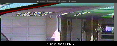

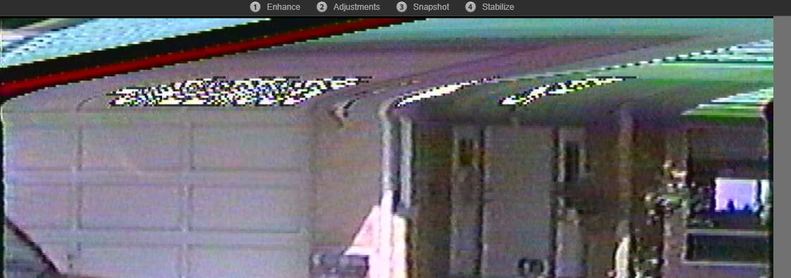

So here it is... After capture using Pinnacle Studio Ultimate, when I preview the captured file, I notice what I would describe as a repeating but temporary "tearing" or "skewing" of the picture at the top of the frame. It seems to happen approximately every 4-6 seconds, only at the top of the frame and lasts usually only around 1 second. Then back to normal for a few seconds, then rinse/repeat. Please see attached screenshot and let me know what to call this issue and if anyone has any suggestions on a filter or process to try, please don't be shy. One last thing, I could be wrong, but I am pretty sure this was not visible during the playback of the VHS during the capture on screen.

	Thanks for the reply. I'm aware of the limitations of post processing software fixes with video and VHS. IE: I know "garbage in/garbage out" and that filters and "enhancements" post capture can only do so much and often make it worse. I understand that ultimately with VHS capture, TBC and source signal/hardware is where the greatest enhancement lies. What the original post was asking in short: what is the issue seen in the screenshot at the top of the frame "called"? What can I "call" that issue when referencing it to someone? Because "smudged color skewing" doesn't quite sound like a good description. I'm trying to simply figure out what that issue is. I know there is likely no software or filter that will fix everything. My only issue with this problem is that I was not seeing it at all as the video played during the capture. The preview of the live video playback during capture was NOT showing this skewed picture at the top of the frame whatsoever. I only saw it after watching the captured video file. If it wasn't occurring during playback (although it certainly looks like a typical VHS tape issue), why would it suddenly show up in the captured output? Especially if it is NOT a software issue as you mentioned.
 So again, short version: What is the issue pictured in the screenshot at the top of the frame "called"? What is the video jargon for that issue? See below screenshot again.
