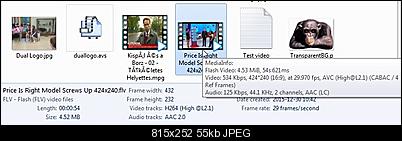

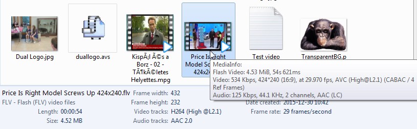

    Anyone know why a video created by ffmpeg as 424x240, measures 424x240, is shown by Media Info (bubble at right below) as 424x240 but Windows 7 Explorer shows as 432 x 232?
Name:	ScreenHunter_182 Dec. 30 10.51.jpg

    Baldrick and Mr.Delusional Thank you for your replies. They were very helpful and much appreciated. I thought I'd leave my resolution as well for others. I realized that not only did the information not match but Vitualdub died with an unknown error each time I tried to load an MP4 through an Avisynth script. This used to work fine. ( I don't allow things that fail on my 'Puter LOL) . The worst failure was that the program I wrote that does most all that people request here would not play MP4 videos through directshowsource either. It posted an 'wMultiOf cannot be zero' message even if I tried to set the wMultiOf setting.
    And , yes, I'm aware that DirectshowSource is a crap Avisynth use but most people have one if their computer plays the videos at all so I wanted it to work.
    I also built in the FFmpeg2Source as well but again, I wanted DirecvtShow to work as well.
    It appears that one one the 'free' programs I was trying out altered or damaged one of the Directshow codecs. I'm not sure which one because even swapping out different ones caused the same error. Best I could pin point was that GraphStudioNext said my computer was using 'Async' as its directshow codec for MP4.
    Long story short, I removed my damaged and missing codecs and reloaded them and everything went back to normal. Now GraphStudioNext displays Lav codecs as the directshow as it should.
