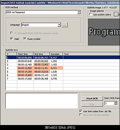

    Just for my own information, is it normal for this type of sub to have what looks like overlapping time stamps?

  9. Originally Posted by sambat View Post
    Usually I use ffmpeg to directly produce a .mkv-Container out of the .ts-file I get from recording digital satellite television (DVB-S/DVB-S2).
    For subtitles i use the "-scodec dvdsub" option ffmpeg provides. It transforms the DVB bitmap subtitles to DVD bitmap subtitles.
    In other cases I can only use teletext subtitles.
    In the specific recording this topic is about I recorded the french channel W9 HD and tried my usual ffmpeg-approach. While there was no error message the result had an issue: The subtitles weren't at the right position of the HD picture, instead the subtitles were at a position in the upper left part of the picture, where I would expect them if the frame had an SDTV resolution.
    Because of this bug(?) I had to use Project X for subtitles this time and not ffmpeg's "-scodec dvdsub" option.
    This surely isn't an answer to your question, but I though this information could be relevant. I haven't checked whether subtitles overlap when using ffmpeg's "-scodec dvdsub" option.
