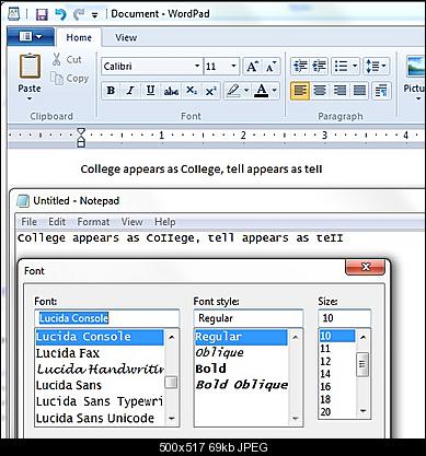

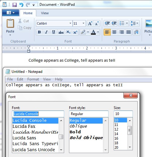

    Could it perhaps be that you are caught in the Default Notepad bug? If you use a font like Arial, the letters II and ll will look the same but are not. Changing the font to Lucida Console (and others) will allow correct display. If you have the wrong font in notepad it will 'LOOK' correct but isn't.
    The following are cut and paste messages from your answer. BTW.. my email reader showed both words in your answer as the same because its font is different than my Notepad.
