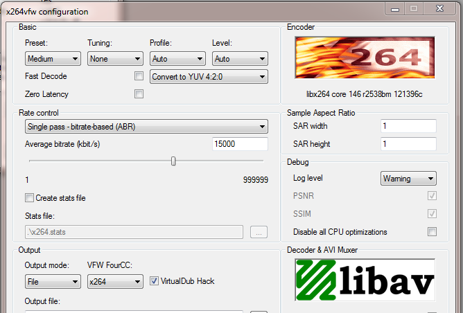

    Originally Posted by texas1 View Post
    but the section about bit rate is greyed out.
    Are you sure of that?

    where did you get that version of x264 ? I got mine from Sourceforge http://sourceforge.net/projects/x264vfw/
    mine looks very different from yours
    Apr 2007
    nevermind -- it's the ABR (not ratefactor based CRF) setting that is the key that allows for choosing the bitrate.

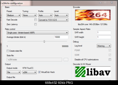

    my original file 600GB+ renamed LARGE.avi. I ran a Single Pass bitrate based ABR (pictured) but had a bizarre result as 2 files were saved as output
    1) a 31GB file with no audio named "vdub" as per my specifications in the picture (path not shown) (NO AUDIO has Video)
    2) a 3gb file with no video that I had called "trial" and initiated when we do the Save as AVI to start the encoding. (NO VIDEO has Audio)
    I had the video in Full Processing Mode, same with Audio which was no compression PCM. Should it be Mp3?
    I just want a simple encode but this is much too complicated for simple tasks. What are the right configurations?
  18. Did you set x264vfw to output to VFW or to a file? If you did the latter you will get no audio in that file. VirtualDub should have saved the audio in another file.
    Apr 2007
    yes, after I posted my last post a few minutes ago I realized the mistake that you also just indicated. That is why I had 2 files, one audio and one video (a much too complicated scenario for a novice)
    So, I set everything to Load Default settings and am retrying now and it's going much faster.
    I guess with so many options on Vdub, it can be confusing for a newbie, but so many options can also be a strongpoint of the application.
  20. The file produced directly by x264vfw can only contain video because the video codec doesn't receive any audio.
