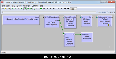

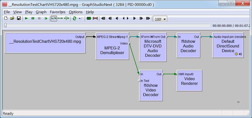

    More or less. Reading the container and splitting audio and video (and other) streams can be performed by the player or by system installed filters. A player will piece together a "filter graph" of internal and/or system components to play a media file. Here's what a typical graph looks like:
    Starting on the left you have a file reader, followed by a file splitter (aka demultiplexer), then audio and video decompressors and renderers. Sometimes the reader and splitter are the same filter. Sometimes other filters are added to overly subtitles, convert colorspace, etc. For system installed filters there is a priority system that specifies which filters have priority when you have multiple filters that can perform the same function. There are also programs that can let you change those priorities.
    The idea is to have a flexible, modular system where anyone can create their own containers, codecs, and renders and have them play on any Windows computer simply by installing the filters. Unfortunately, along with that flexibility comes complexity.

    I don't know about GSpot in particular but there are filter editors that will show you installed filters, their priorities, etc. But they can only show system installed filters. They will not show you filters built into various players and editors, and not available to other programs.
    Some players, like MPCHC, will let you see what filters are being used during playback.
    Wow, that's quite an illuminating chart you give. And impressive too! I am now starting to see what the programmers devising these mechanisms had in mind. I am also starting to see why most of the people I know don't even bother anymore to copy their video's to a computer; they play them right from the SD-card by simply connecting their video-camera to a TV or only on the smartphone or tablet they made them with. As a former IT manager (albeit in a very different field) I'd say that this level of inter-dependance between components of very different origin is bound to create problems. It is, in my experience, practically impossible to formulate a standard which cannot be interpreted in different ways.
