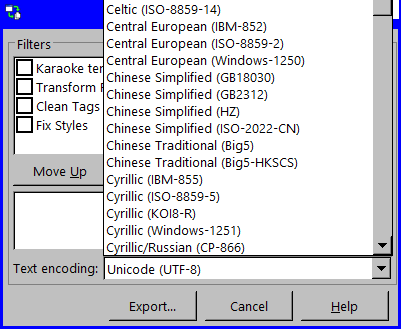

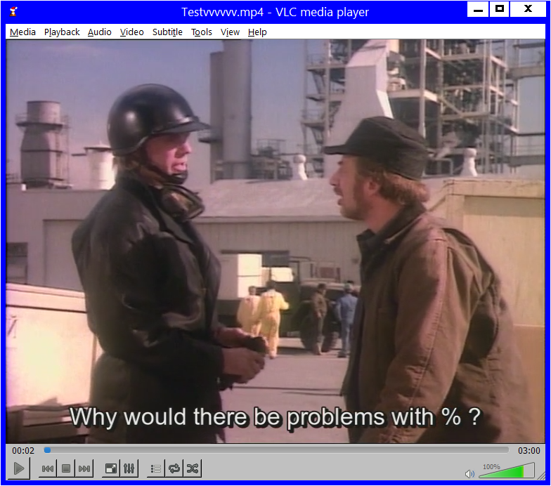

  2. I've no problems. Are you using the same character encoding when exporting in Aegisub and importing in Vidcoder? Perhaps upload your subs.

    .srt is merely a text file using some character encoding. When you export it from Aegisub you select the encoding to be used and similar when importing in Vidcoder (both default to UTF-8).
