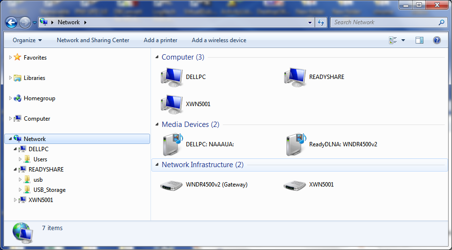

Normally, when things are working, I have the following showing in the network listing, below. But when it is not working (when the \\readyshare folder is not accessible), then the \\readyshare tree branch does not show. Thus, there is no way to do a "refresh" since there is no open folder.
Right now, I have access to the folder. And, the laptop has gone into sleep mode (and hybernation mode) many times since I last reboot the router. I am waiting for it to fail. Therefore, it may not be when it goes to sleep that the folder becomes inaccessible. There must be some other underlining cause, though it could be coincidence or random, when the laptop comes out of sleep, that I don't have access to the folder and that I am blaming it on sleep.

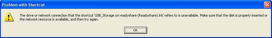

Ok. Today the problem has resurfaced, only this time on my desktop pc running windows xp home.
I just booted it up and then tried to open the \\readyshare folder on the desktop screen and got this message.
