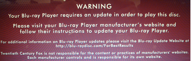

  9. Guys, are you sure this is really Cinavia-related? See attached image.
Name:	Screenshot 2015-12-22 18.32.50.png
  10. Banned
    Feb 2013
    Not Cinavia
    You cannot copy the AACS protection to another disc (your burner is not licensed)
    Bad disc is most probable reason
