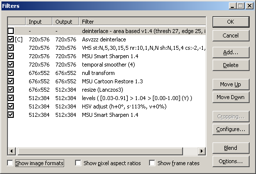

    [Attachment 34899 - Click to enlarge]
    How can I tell if my source is interlaced or not?
    BTW, I have attached a picture of the chain I want to try. My source already looks great. It's a VHS rip of the few Charlie Brown specials that Warner Bros hasn't put out on DVD yet. I just want to color correct it an smooth out the grain and pixelation.

    A PAL Charlie Brown cartoon probably used speedup from 24fps with no interlacing. But the fields may not be aligned into full frames ("phase-shifted") and there may be residual interlacing from VHS timebase errors. Not sure what VDub filters exist for dealing with that without deinterlacing when not necessary.
    If your goal is to improve the quality, don't resize. Especially not a vertical downsize.

  8. Your image appears to show a PAL (720x576) source. Rare NTSC videos are often converted to PAL with field blending. Videos like that should have the blending removed with QTGMC().SRestore() in AviSynth.
    Jan 2009
    No wait, I didn't realize that was a PAL filter chain. I'm working in NTSC. And my encodes look great. There don't seem to be any framerate - related artifacts visible. I'm mostly concerned with color correction and grain reduction.
