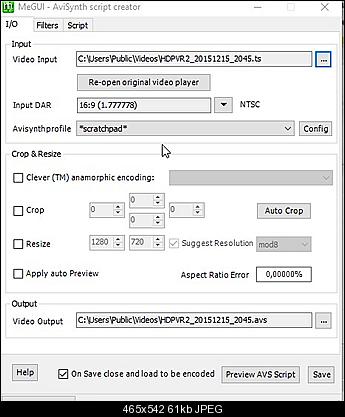

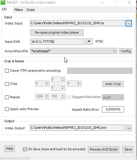

    In MeGUI, I go first in the Tools menu -> AVS Script Creator

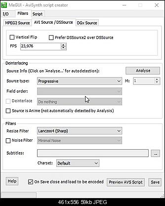

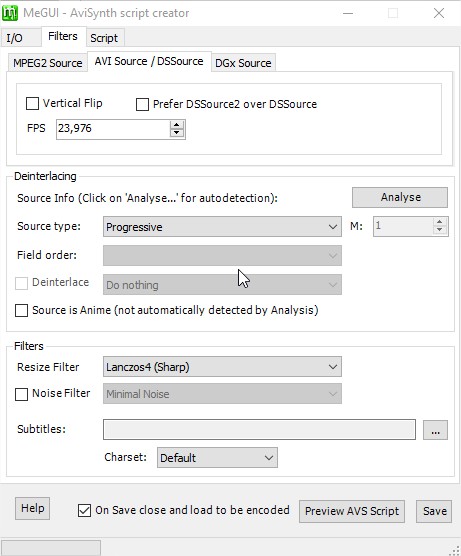

    In the Filters tab, I put 23,976fps value as the source of my TV decoder. The source is progressive (720p).

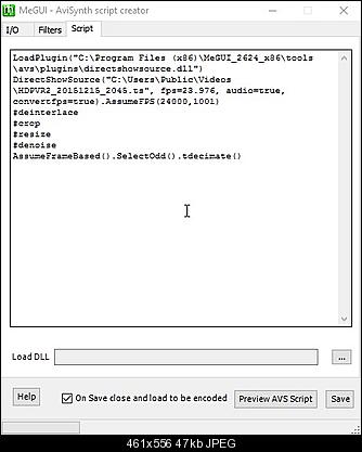

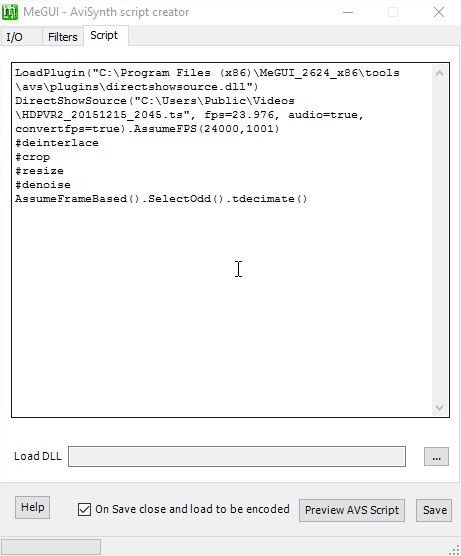

    In the Script tab, I was advised to add the command : AssumeFrameBased().SelectOdd().tdecimate(). And changing audio = True

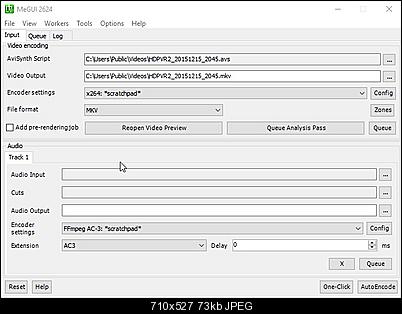

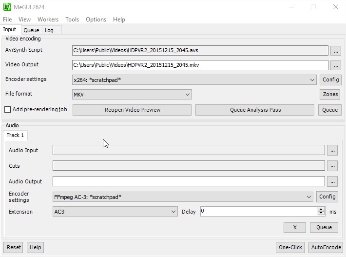

    The Save button, I return to the main screen. Note that there is nothing in the audio section.

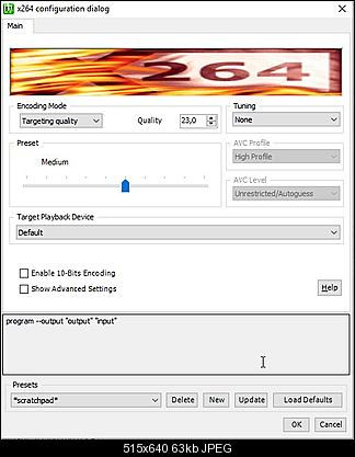

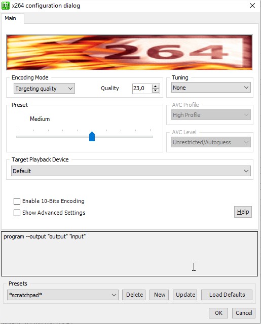

    On the Config button on the video section I can change the quality of the output file. I leave the defaults. Is it correct?

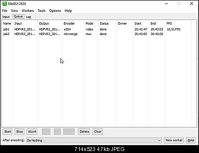

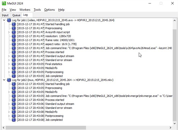

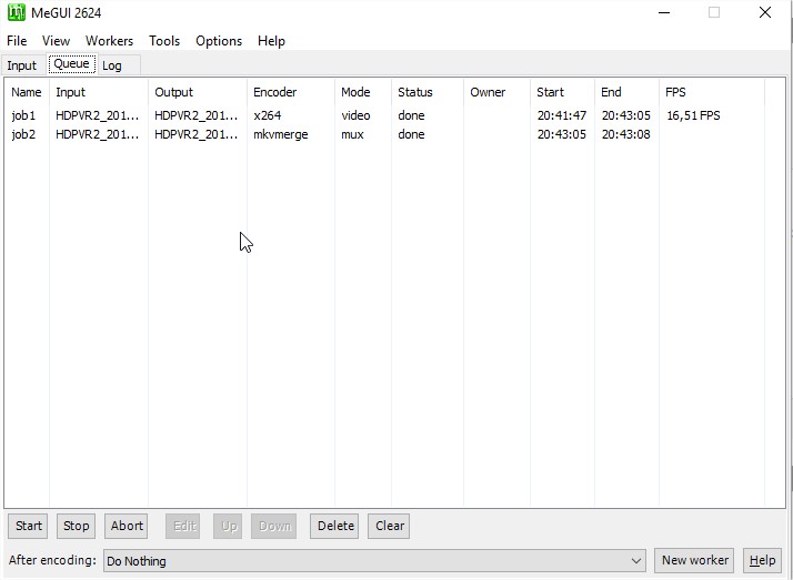

    On the Queue button on the video section, a message appears. I click YES and MeGUI generates the MKV file. I enclose the details attached (MKV.txt).

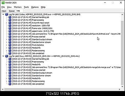

    I have no audio in the video!?! How can I add?

  3. Don't use DirectShowSource.
    Open the TS file via the File/Open menu or via the Script creator, and when MeGUI asks how to open it, choose the "file indexer". When it opens, add the indexing job to the queue. Run it.
    When the indexing is done, the Script Creator should open. Don't specify a frame rate (unless you opened the video with DirectShowSource or AVISource you won't be able to anyway). Don't change audio to "true" even if you can.
    Don't add AssumeFrameBased().SelectOdd().tdecimate() and don't ever listen to the person who advised you to do that again.
    If the source is progressive and you don't want to crop or resize, simply save the script for encoding.
    The script should be loaded into the video section for encoding. Set up the x264 encoder configuration, add the script to the queue and run it.

    When you open a file and index it, MeGUI will (if audio is selected in the file indexer) extract the audio and add it to the audio section for encoding. It can't always extract the audio (it depends on the file type). If it can't, it'll create a script for encoding the audio and load it into the audio section. You can use the queue buttons in the video and audio sections to encode each individually and mux them together yourself using MKVMergeGUI, or one of the muxers under the Tools menu.
    Alternatively, you can use AutoEncode. It'll re-encode both and do the muxing for you. If you don't want to re-encpde the audio and you extracted it with the file indexer, use the "x" button to clear the audio section before clicking AutoEncode. If the "add additional content" box is checked when the AudoEncode window opens you'll be able to add existing audio (extracted audio) to the output rather than re-encode it.

    PS I just noticed your source seems to be 59.940fps progressive (according to MediaInfo). I'd keep it that way.
    If you open the video with DirectShowSource and specify 23.976fps it'll drop frames to reduce the frame rate and it'll probably be ugly. In your case you then added SelectOdd() which would delete every second frame and reduced it further to 11.988fps and to top it off you followed that up with Tdecimate() which will delete one frame in five. Fortunately though, I think you at least failed adding SelectOdd and TDecimate to the script (if you change something in the script creator MeGUI will rewrite the script and you'll lose any manual changes) because you did encode at 23.976fps.
    PPS. In MeGUI's options, under "external program configuration", if you uncheck "x264, use external muxer for MKV" the encoder output should be written directly to an MKV file. Currently it's being written as a h264 file then muxed into an MKV, hence the two steps when you added the video encoding job to the queue.
