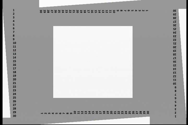

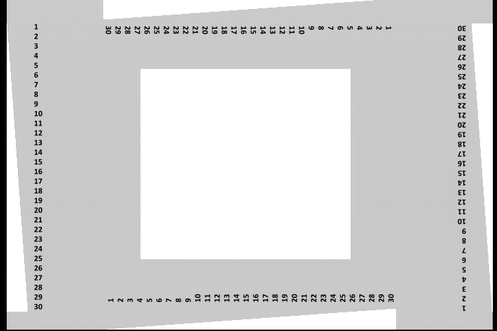

  14. Dinosaur Supervisor KarMa's Avatar
    Jul 2015
    US

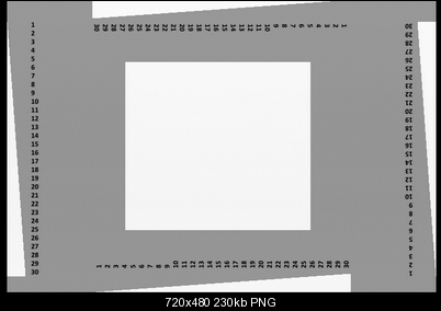

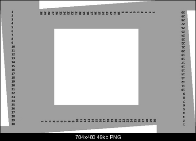

    I took jagabo's test pattern and made a video out of it, making sure to keep the 704x480 on the DVD. Picture below is a VLC cap, straight from the VOB file.

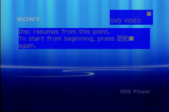

    And then this is what it looks when I play the DVD on my cheap Sony DVP-SR200P DVD player, into my Hauppauge 1250 capture card over composite. It captures at 720x480.
    It's not stretched as I had expected, but seems to automatically create the black bars on both sides. Behaving similar to just adding black bars to a 720x480 video.
    This is what the Sony graphical splash screen looks like through my card, filling up nearly all the picture. https://forum.videohelp.com/images/imgfiles/egBqxI5.png . So the DVD player is certainly maintaining the AR, the way it is supposed to over composite. And if the DVD was played over HDMI it would not need to add black bars.
    Yep, that is exactly what is supposed to happen.
    Indeed, and that is exactly why I prefer 704x576/480 over 720x576/480 – it get displayed correctly no matter where. If you resized to 720 it also would be correct over HDMI (with most players it seems anyways), but Composite would not.
  17. Originally Posted by KarMa View Post
    Yes, players are schizophrenic. They follow the ITU spec at the composite output (probably because they use standard video DACs), the MPEG 2 spec at the HDMI output.

  21. Dinosaur Supervisor KarMa's Avatar
    Jul 2015
    US
    Originally Posted by Skiller View Post
    Originally Posted by SameSelf View Post
    I wonder how jagabo's test pattern would perform for a widescreen version.
    Go ahead and test it (just flag it as 16:9 and re-author it, nothing else needs to be done), but I guarantee it's going to look identical when captured with your Hauppauge. There is no way it could be different. I would eat my hat if it was different.

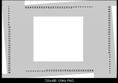

    I forgot to mention that my captured image in post #74 was actually flagged as 16:9. This is what I got with 704x480 flagged at 4:3.
    Don't know why the brightness is so different but they have the same black boarders.

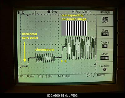

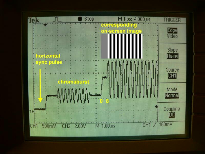

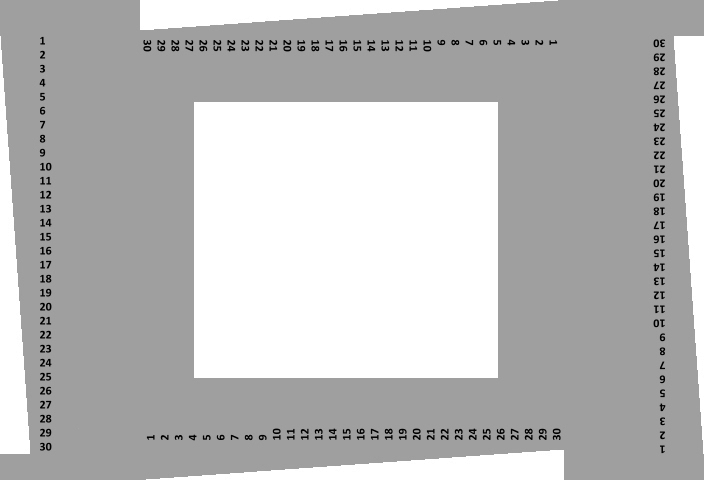

  22. Here's a scope trace of a 720x480 4:3 DAR video playing on a DVD player (Philips DVP-5990) via composite:
    Only the first ~5 percent of the scan line is displayed, from left to right. At the left is part of the horizontal sync pulse. To the right of that you can see the chromaburst signal. You don't see either of those on a normal TV. The number 0 corresponds to the first pixel of the 720 pixel wide DVD image, 8 is pixel number 8. The inset shows the corresponding portion of the picture that's being displayed on the TV. The source was 720 pixels wide with 8 pixel wide grey borders at the left and right edges. The middle 704 pixels are two pixel thick white and black vertical lines.
    I didn't bother photographing it, but when displaying a similar 704x480 4:3 video with only the white and black lines (ie, the grey borders were removed before making the video) the lines were in exactly the same position and the 8 pixel wide grey borders were replaced with black borders by the player.
    So this player follows the ITU spec at the composite output. When playing a 720x480 video the 4:3 image is contained in a 704x480 sub portion of the frame. With a 704x480 video the full frame corresponds to the 4:3 image. A TV would show exactly the same aspect ratio for both. If you could see the overscan area you would see the grey border of the 720x480 video, a black border (added by the player) with the 704x480 video.
    As noted earlier, this differs from the upscaled HDMI output where both the 720x480 and 704x480 frames are upscaled to the full 1920x1080 frame -- leading slightly different aspect ratios.
  23. Member Skiller's Avatar
    Oct 2013
    Germany
    Thanks for all the efforts. It confirms what I observed myself when capturing the outputs of DVD-players.
    Right, so the conclusion is: 704 is displayed correct for both analog SD outputs as well as upscaled HDMI (and software playback on a computer also). So why not show some more love for 704, guys?
  24. Originally Posted by jagabo View Post
    This is a sticky-worthy post. Thanks jagabo and KarMa for the tests. Great job!

    It comes down to two things:
    1. What does the authoring program accept? If the authoring package accepts 704 pixels wide as DVD compliant then, sure, give 704 all the love you want. DVD Architect accepts both 704 and 720, but I really see no point in choosing 704, a holdover from the analog broadcast days. If the authoring package considers 704 pixels wide non-DVD compliant and will transcode, you are stuck. You have no choice but to encode as 720 pixels wide. At this point it is up to you whether you want to add black borders or stretch the video. As for which one to do, refer to the next rule.
    2. Does the display show the black borders? No way of knowing for sure without a test. Here is what my set up through a modern DVD/BD player, HDMI, and modern HDTV does: it displays the black borders. Ugh! So, going forward, if my authoring package forces me to encode as 720, I will be stretching the video because that is far more aesthetically pleasing than ugly black borders. This is of particular importance when downrezing HD content for DVD.
    Optional Rule 3: So your dinosaur player and TV don't display the black bars/overscan area. Now your stressing about the edges of your image getting cropped if you stretch your 704 content. Your coming here for advice. You get confused and don't know what to do. Here is a tip. Embrace 720. One of these days the dinosaur player and TV will go to the dump, and it will be like a gift of 16 pixels that you never knew you had
    Otherwise, this is a great thread. Tons of solid information from lots of contributors and should really be made a sticky.

    My opinion is, it's not as if you will be able to tell a difference in detail/resolution between 704 and 720 (without borders) when watching the thing on your TV, and considering, as we found out, 704 is displayed correctly in every scenario, I see no reason not to prefer it over 720.
    If your authoring software doesn't accept 704 then I would question my choice in authoring software and then if I still wanted to use it I would just simply trick it by patching the first res header of the m2v file and fool the ignorant authoring software.
    Honestly, the only place where I use 720x576 are the menus. Simply because some players don't place the button highlight subpics exactly where they belong when the underlaying menu is encoded in 704x576.
  28. Originally Posted by SameSelf View Post
    Even though it appears a 704x576 resolution will always display the same way (ie correctly) it still isn't worth considering?
    Are you saying your TV never overscans? Or that it can't overscan? Because that'd probably make it unique. One of a kind. As far as I know all TVs overscan broadcast pictures and generally you can't disable it. I'd have thought there was probably more chance a TV would always overscan than not overscan at all. I kind of remember my other half's old 720p LCD TV always overscans without an option to disable it, but I'd have to check again.
