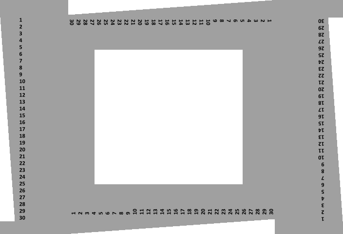

  13. Originally Posted by Skiller View Post
    Have you ever tested what happens if the source picture is 704x576/480? Does it get resized straight to 1920x1080 as well?
    I just made a DVD and tested it on my LG BD670 Blu-ray player with the player upscaling to 1080p. Both 720x480 and 704x480 16:9 DAR get upscaled to 1920x1080. Every pixel of both sources is visible and they completely fill the 16:9 TV screen (no overscan on the TV, I used test patterns that would show if part of the picture was cut off). 4:3 DAR both fill a 4:3 portion of the screen (1440x1080) and every pixel of the DVD is visible. So that player follows the MPEG spec.
    Sample 704x480 image used:

  16. Originally Posted by jagabo View Post
    Great work jagabo! Thanks for testing that. That seems to indicate what I thought, that modern players and TVs, via HDMI, display the full 720 pixels. Please feel free to correct me, if I am misstating your results.
    Interestingly, DVD Architect allows one to choose between 720x480 or 704x480 NTSC. So I tested a quick 704x480 encode, and brought it into DVDA and it accepted the file without triggering a re-encode. Encore complains.
    Since I am planning to use DVDA anyway, AddBorders is not needed. No need to conform to 720. Or is there?

  17. Originally Posted by SameSelf View Post
    Yes, that is correct.
