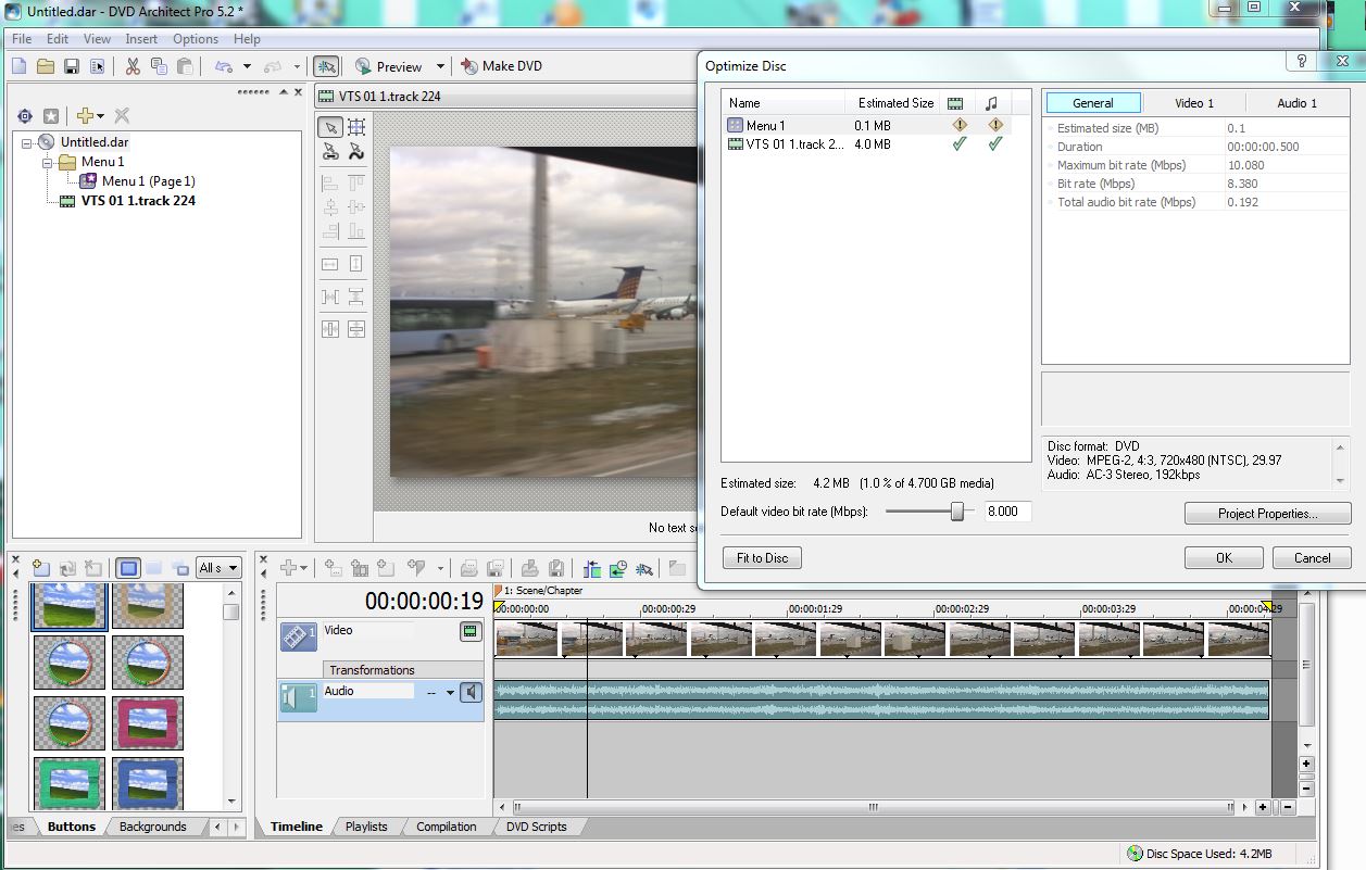

  10. This was discussed here before already from time to time, 29.97p source after downsizing in Avisynth could be encoded as progressive (HcEcoder), in INI file:
    *PROGRESSIVE
    or in HcEncoder gui:
    Settings1/interlacing options - progressive and select also TFF. It has to have that TFF or BFF flag, even if it is not.TFF and BFF selection must be selected even if progressive encoding is selected.
    Muxman indeed makes VIDEO_TS no problem. ImgBurn would make DVD. I did my DVD's mostly like that, nobody ever complained.
    I happened to post here VIDEO_TS sample of downcorverted HD 29.97p video to DVD. Made by HcEncoder and muxed with Muxman.
    For DVDArchitect you'd need separate mv2 and AC3 strams, DVD Architect does not seem to re-render that video again, I just used demuxed video stream from VOB of that DVD but it should be the same with original m2v:
