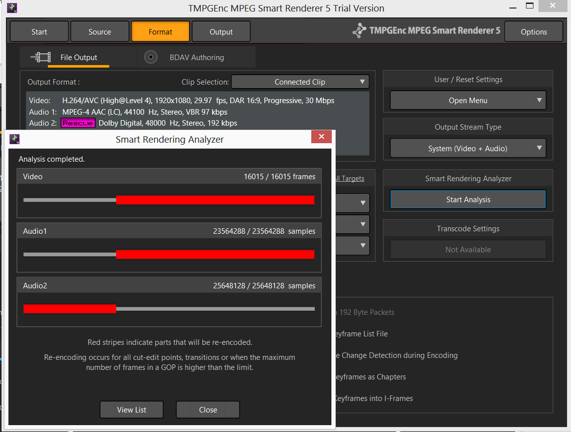

    A picture is worth a thousand words. Here's the screen grab of the SR5 Smart Rendering Analyzer, which tells the user which portions of the final clip being requested will be smart-rendered (i.e. not encoded but merely copied, for the most part) and which portions will be completely re-encoded.
    Note that those portions which will be smart-rendered are shown in grey and those portions which will be re-encoded are shown in red. (Note that the second clip had two audio tracks while the master clip had only one. SR5 resolved that by leaving the audio track of the master alone (of course) but creating a second track from scratch for the master clip which was an encoding match for the second track of the second non-master clip, which it left alone and smart-rendered. Meanwhile it did the opposite for the master clip's single audio track, smart-rendering it but then re-encoding the first track of the second non-master clip to match the parameters of the one and only audio track of the master clip.)
    The bottom line here: There is no confusion here. I wish to use smart-rendering in order to preserve quality and downgrade the quality of the original video as little as humanly possible. That is precisely what SR5 is doing for me in this example. The problem is not what SR5 is doing; it is doing exactly what I want it to be doing in this example. The problem is that it sometimes intermittently gets super-finicky about certain files for reasons which totally escape me, as, for example, it did with that flv file which triggered the current exchange. When it gets a finicky attack, it screams that there is "No Smart Render-able clip", and when that happens I have yet to come up with a solution. That is, hopefully, where folks in this forum can come in.
    Or, at least, that's my first choice. If there is no solution to this SR5 problem, that's O.K. if we can figure out how to encode non-matching clips to match my master clip with VRD. If we can do that, then I'm happy to pay the extra $26 for VRD. But my first choice is to solve this "No Smart Render-able clip" problem, if we can, because SR5 is cheaper.
    The only solution that I've come up with so far is to use both, meaning I have to spend $166. Well, before I do that, I'd really like to hear from some more experienced people here about other possible cheaper solutions to these two problems, preferably one for the SR5 glitch but, if not, then for the VRD encoding conundrum.
    I hope that all makes sense, and thanks for any suggestions anyone may have to solve one or both of these problems.

    I tried TMGEnc Smart Renderer 5 today. It handled the minor glitches in the recording that I edited (an H.264 TS file from my CableCARD tuner) well enough, but stripped the closed captions.
    Fortunately that's not a deal-killer for me. What IS a deal-killer is this intermittent "No Smart Render-able clip" message, for which I'm still hoping there's a solution out there.
    Alternately, I hope there's a means out there, other than SR5 (because of this intermittent SR5 problem), of re-encoding certain clips so they will match master clips that I do NOT want to re-encode.

    I just tried adding dissimilar clips to the joiner list...It refuses to add anything which isn't similar enough to the clips that are already in the list.
    Yep, that's what I found out also. The way to solve this in VRD, apparently, is to somehow first pre-encode the unmatching files before doing your joining. The goal is to pre-encode them with parameters which match those files that are already in the Joiner. In my case, I would first put into the Joiner those files which have parameters of which I approve. Once I've done that, the trick then is to pre-encode new copies of the other files so they match the files already in the Joiner.
    And that's where I'm stuck. I've yet to figure out how to grab a file's parameters and then tell the VRD encoder to use those parameters and encode the other files to match. I have a hard time believing there's no way to do that. And considering that SR5 does precisely that (albeit with an overly limited selection of files), I'm also in the hunt for another piece of software that also does that, even if VRD is not capable of doing that.

  29. For your FLV that "failed" in TMPGEnc Smart Renderer, can you post the mediainfo report (view=>text)
    https://www.videohelp.com/software/MediaInfo
    You said videoredo handled it, but what operations did you do in videoredo ?
