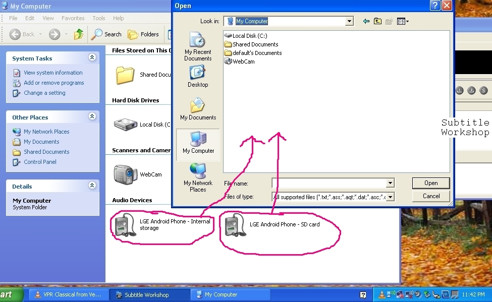

  1. Is there a way to modify computer to allow browse android device in Open window? I can transfer files from computer to android device by clicking on
    LGE Android Phone (see screenshot) but for some reason the android device doesn't appear in Open window when browsing for a file. Here I am using Subtitle Workshop to browse for a file on the android device, but the android device doesn't appear in the Open window.

  2. Member Cornucopia's Avatar
    The "reason" is that your android phone isn't SHARING its files over a network, nor letting the PC be mounting the raw filesystem of the storage areas of the phone, it is using USB protocols & drivers to tell the PC how it will interact.
    And how it will interact is as "Audio Devices" (as seen in the picture behind the picture). It isn't visible in the dialog box picture because, as an Audio Device, that is not where you would see those volumes (IOW, not in that context). You MIGHT see it if you were using an audio app (as it would tell your PC that you were wanting to deal with an audio device, and so the PC's OS would talk to the driver which exposes those "devices").
    There may be a way to get around this: sometimes you are given an option on HOW you want your phone to connect/interact to your PC (mine gives me a "charging only" and a "file system/remote storage/upload-download" option, but NOT an "audio device" option), which you could change to a more appropriate scenario.
    Otherwise, the much faster & more prudent thing to do is just take your SD card out of your phone and put it in a SD card reader to be mounted on the PC as a removable drive. I do this all the time (though I always turn my phone off first so there aren't any missing filesystem "expectations" on the part of the phone's OS).

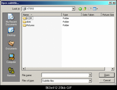

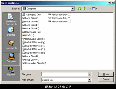

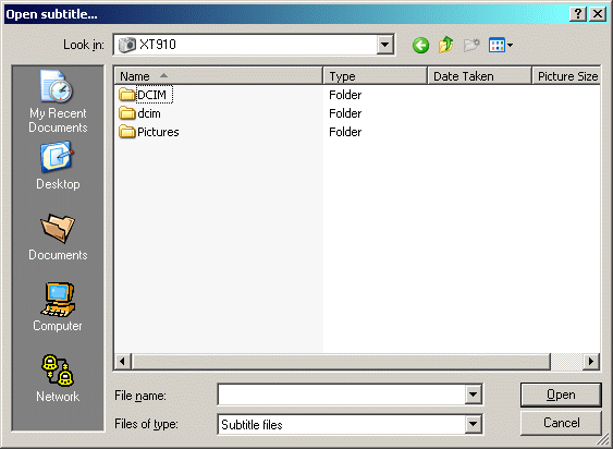

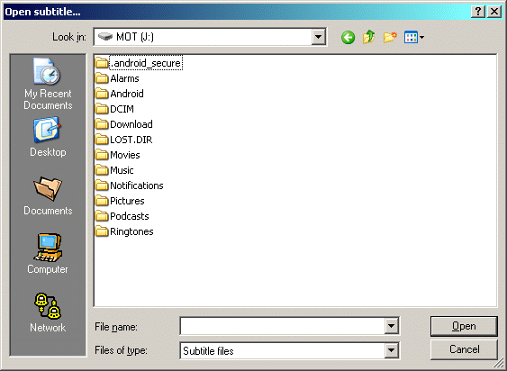

  5. Like this? Drive MOT (J) is my Motorola Razr's internal storage and Removable Disk (K) is it's SD card.

    To not really answer your question......
    There's a list of the ways Android devices can connect here:
    http://www.howtogeek.com/192732/android-usb-connections-explained-mtp-ptp-and-usb-mass-storage/
    USB mass storage isn't supported for newer devices (which is how mine was connected above) but you should still be able to access it in PTP or MTP mode. What you can access may be up to the device. In my case Camera (PTP) mode has it show up under Cameras and Scanners and I can still access it's internal storage, but it's more restricted and I can't access the SD card.

    Andriod connecting as an audio device is a new one for me. What happens if you double click on LGE Phone in My Computer? It might relate to this:
    http://www.phonearena.com/news/Android-5.0-Lollipop-supports-USB-DAC-audio-devices-we-...ars-on_id66399
    If you can switch to MTP mode, try that, although I'm fairly certain WMP 11 is required. The top notification thingy should tell you how you're connected when you pull it down and clicking on it should let you change modes.

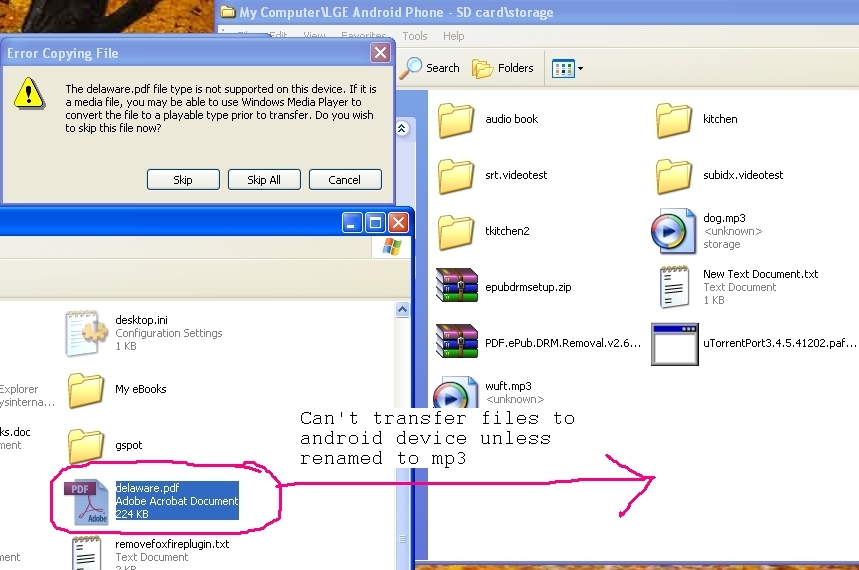

  6. That about explains it. No big deal because I can transfer files between the computer and the android device just by clicking "LGE Android Phone Internal/Sd". One other minor problem is that no files except mp3, jpg and a few other files can be transferred from computer to android device. The way around this is to first rename files to mp3 that you want to transfer. After transferring the files to the android device, they can be renamed using the android device. See screenshot.This quirk is because I have Windows Media Player 10 on my computer. If I upgrade to Windows Media Player 11, this transfer problem would be solved. I'd rather find a way to modify the computer registry (if somebody can tell me how) to solve this problem. This Android device is a good Walmart deal for $10. Just the included 4GB micro SD card and the weekly McDonald's coupons are worth $10.
