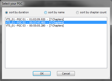

    It happened to be an old DVD, with interlaced video. My understanding is there are only two titles: one with the main movie including all three episods and the other with extras. If I want do create chapters, I understand I need to load VTS_01_0.IFO. Once I have done it, the following window appears:

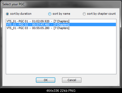

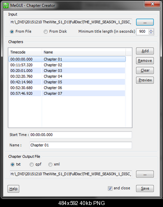

    There are different PGCs, thats is ProGram Chain. I am not exactly sure what it is but I can choose only one. Then I have a list of chapters in following window:

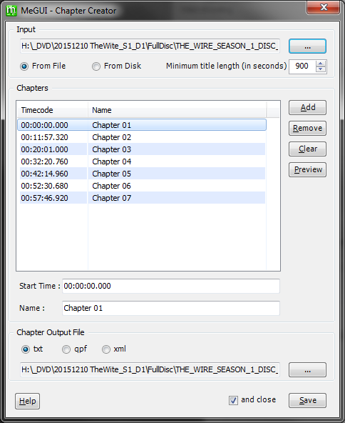

    As you can see, it begins at 00:00:00. It is the case with each of them regardless of PGC selected, even though it says VTS_01 - PGC2 begins at 00:57:47.400 in the previous window--I have selected PGC2 for this example.
    What can I do to include this particular offset, for instance 00:57:47.400? If I extract chapters this way, I end up with each of them beginning at 00:00:00 which is obviously wrong.

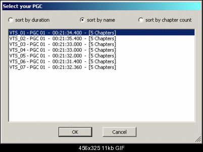

    I'm not sure if there's any way around your problem, aside from manually adjusting the chapter timecodes, as I've always prepared the DVD for encoding the way I described, but here's what happens when you re-author a DVD as I suggested. In this case the DVD contained seven episodes of a TV Series, all in a single set of vob files (much like the DVD you have).

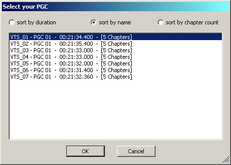

    After re-authoring, instead of PGC 1, PGC 2, PGC 3 etc, when you open the Video_TS_IFO file they're all PGC 1.

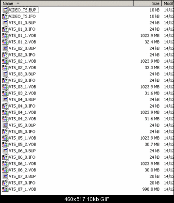

    But there's also an individual IFO file for each episode containing just the chapters for that episode.
Name:	ifo files.gif

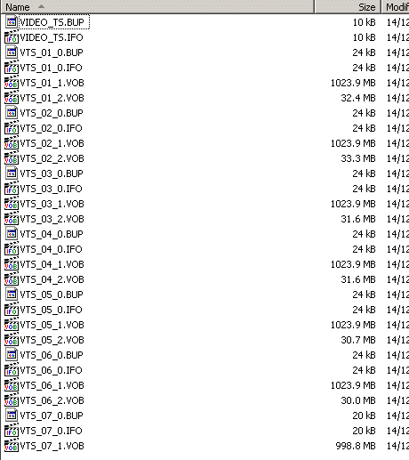

    Each IFO file corresponds to a vob file, or set of vob files, for a particular episode.
    And it's a much better way to encode episodic DVDs.... as individual episodes..... rather than encoding multiple episodes as a single file..... in my opinion, and as I said, you can re-author the ripped files rather than open the DVD with DVDShrink (use the "Open Files" menu), but set the target output size to something large in preferences so it doesn't try to shrink when you re-author.
