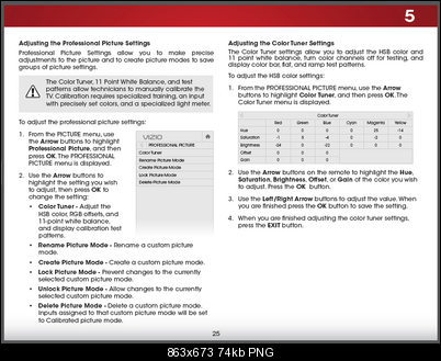

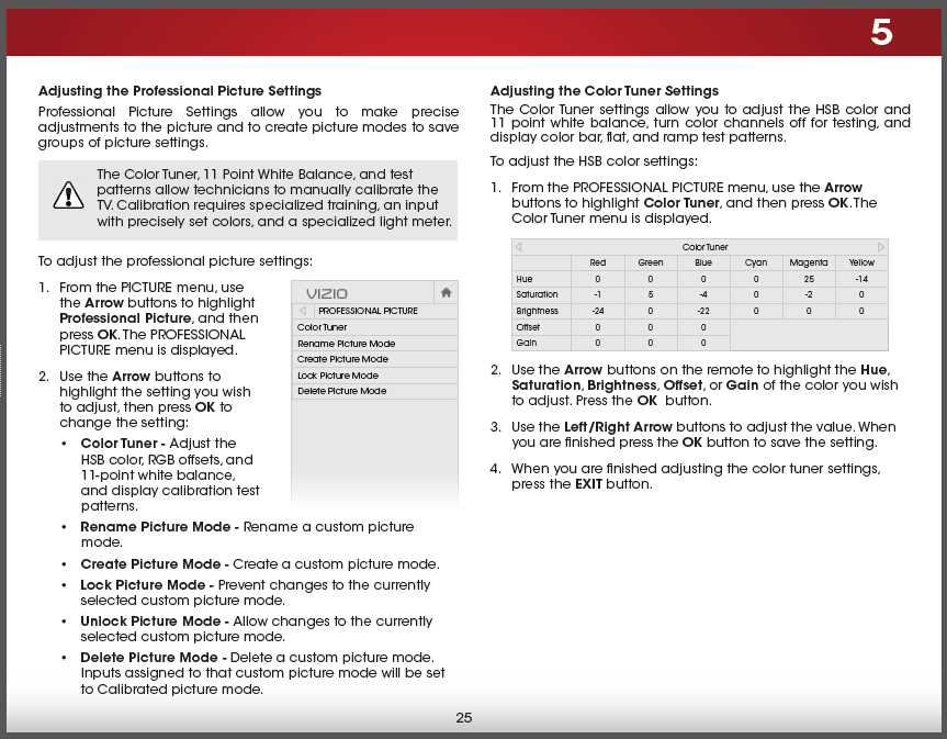

    Originally Posted by DaneClark View Post
    I have a Vizio e420i smart tv. It took lots of trial and error to get the picture to look right and I want to know how to go into the factory settings and make a few minor tweek to fix color casting and crushed black levels
    How does the picture "look right" if it has a color cast and crushed blacks? No way. There's nothing in the service menu that you don't already have in your user menu for image adjustment. If you don't know how to use test patterns and measurement tools, you're wasting your time in the service menu -- there's no "Fix My Picture" button in there.
    Doesn't your television manual tell you where to find the color and black/white level adjustments?
    It does. On page 25. But who reads manuals?
    Like manono implies, it's impossible to calibrate by trial and error, which is what you're doing. There's an old calibration guide that tells how to use tools your TV already has without borking your set in the service menu. The hardware and software shown in the link have new versions now, but the methods and graphics still look the same (ignore the "updated" version, it costs too damn much $$$$): http://www.curtpalme.com/forum/viewtopic.php?t=10457. The good news: this is the best way to get a beautiful cinema-standard picture, even with a Vizio. The bad news: it ain't Instant Gratification.
    Passive/Quick-Effort-Gratifaction/Oh-Well-It's-A-Little-Better/Cheapo method: get a HD video calibration test disc from Amazon, like this http://www.amazon.com/Spears-Munsil-Benchmark-Calibration-Edition/dp/B00CKWI13O/ref=cm_wl_huc_item
    or this http://www.amazon.com/Digital-Video-Essentials-Basics-Blu-ray/dp/B000V6LST0/ref=cm_wl_huc_item.
    They help with the crushed blacks and make visible general improvements but might not do much for a bad color cast -- you might need advanced tools for that.
