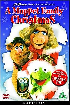

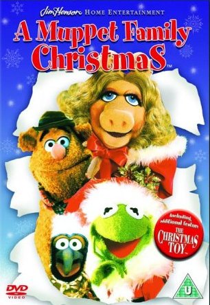

    The U could possibly refer to the film classification. U is a british classification meaning Universal, or suitable for all audiences.
    See the U in the bottom right corner of this picture.
  8. U was not meant to be a region code but simply that it came from England or is in PAL format so I was originally told. The picture that ronmaz put there is the disk I have: original package, title, factory sealed, etc. if that info. helps.
    So are you saying that unless codes are leaked by the company itself, there's really no way of finding codes? What about players that are being advertised as "region free"? Are any of those legit. or are those always scams?

    The front of the disk does not matter. It's what is written on the back that does.
    Does it have that globe symbol with a numeric inside ?. Not all PAL disks are Region 2 so that Muppet disk could already be Region Free. Hey. It could even be NTSC since over here almost all our equipment will play NTSC disks which are not Region 1.

    ...but it appears there are many bootleg DVDs created from various sources in circulation.

    But would it be OK to put a link or copy & paste a picture (if that works) here of the disk I bought if I see it for sale on a site like Amazon or e-bay to show exactly what I have or is that not allowed? (Needless to say I don't know how to upload pictures and don't have the means to do so myself.)

    By all means post a scan of the cover, front AND back, but it is not going to provide any info over and above what we already know.
    You have been advised of what we really need and that is core info of the disk(s) - you said there were two (already alarm bells in my mind)
    Get hold of dvddecrypter. Load the disks(s) and report back on the information that this program tells you.
