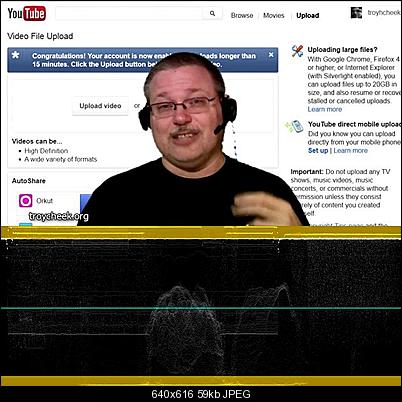

  2. I can't speak to the particular software you're using, but in general:
    The RGB you see on the screen uses the full 0-255 range. YUV video uses the limited 16-235 range. Software/hardware that converts between the two normally accounts for this: when converting RGB to YUV RGB=0 becomes Y=16, UV=128. Conversly when converting YUV to RGB Y=16 becomes RGB=0, Y=235 becomes RGB=255.
    If you upload YUV video to youtube it retains the levels you uploaded. I'm not sure what youtube does if you upload RGB, but I would assume the follow the usual rules for converting from RGB to YUV.

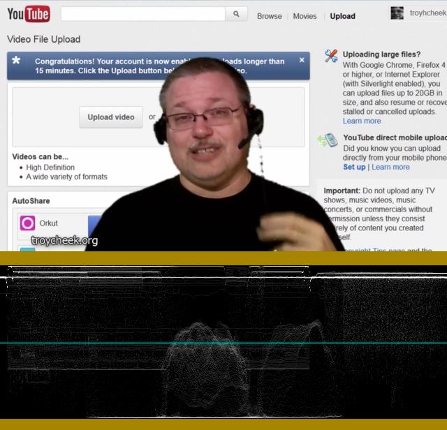

    That youtube video has incorrect levels with Y ranging from 0 to 255. If your computer is set up correctly it will display like this (note the waveform monitor below the image with the Y<16 and Y>235 marked in brown):

    If it had correct levels before uploading it would look like this:
    If the youtube video looks like the second image when you view it your computer is set up incorrectly.
