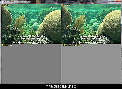

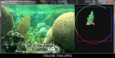

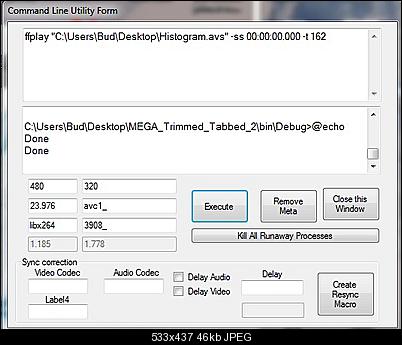

    Yes it is possible, IF you have the latest Avisynth 2.6. Otherwise it tells you this when you try to run the ffplay with avs script.
    DirectShowSource("C:\Users\Bud\Desktop\Frame.mpg") .ConvertToYV12
    Histogram("Color")
Name:	ScreenHunter_182 Dec. 12 01.00.jpg

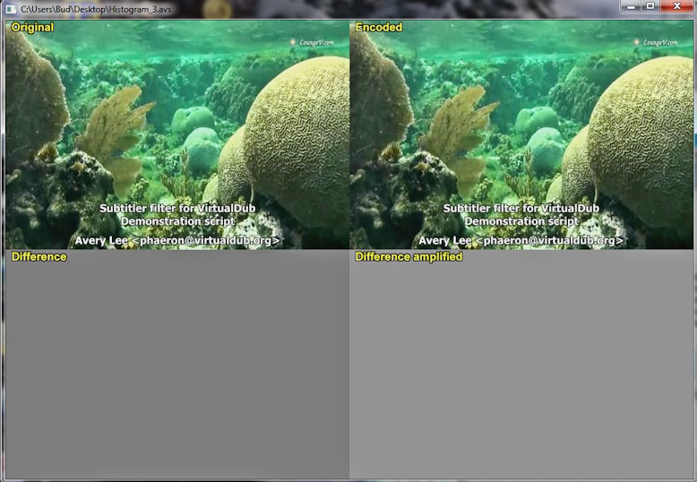

    You can also play scripts that stack and compare more:
