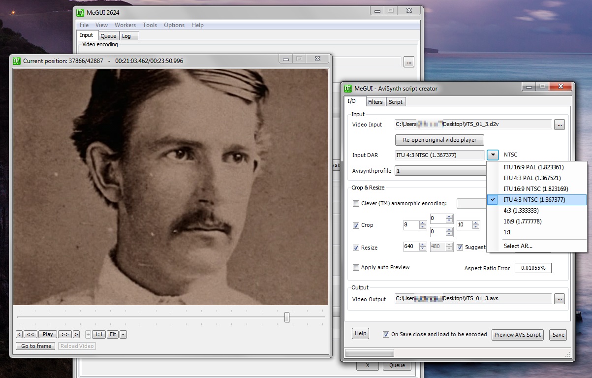

    Maybe I'm missing something, but where I come from, 656 - 18 = 638, not 640.
    You are actually cropping on the 720x480, which then gets resized to your target resolution (640x480 for example). Resizing to ITU 4:3 without any cropping is 656x480. If you are targeting 640x480, then -18 gives you the lowest AR error %, at least according to MeGui.

    You seem to expect to resize, then crop, while what I am saying is you should crop then resize.
    I might not have been clear in the 9th post. Crop first on the 720x480, then resize it. That is what I was advocating.
    crop(8, 0, -10, 0)
    Spline64Resize(640,480) # Spline64 (Sharp)

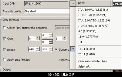

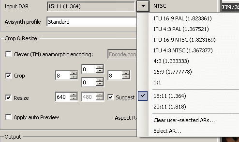

  15. Originally Posted by Cornucopia View Post
    Well, that's MeGUI for you. If the title was digitized to ITU standards, the PAR is 10/11 whether the clip is padded to 720 or not (meaning a padded 720 clip is actually slightly wider than 4:3/16:9, even though it is marked as such). So to arrive at square pixel dimensions, one must undo those steps in reverse order and use the 10/11 scaling factor, which gives you 640x480 exactly, and hopefully 4:3 DAR exacly.
    For the record (and I can't remember why there's a difference in the way the ITU PARs are calculated) if you look at the list of PARs here:
    https://www.doom9.org/showthread.php?p=1058927#post1058927
    MeGUI still uses the "Almost exact and commonly used ITU-PAR", or the second table of PARs.
    Also for the record, if it was up to me I'd switch to using the MPEG4 PARs, partly because I think they're more accurate, partly because they're the same PARs that can be selected in MeGUI's x264 encoder configuration, and partly because when --bluray-compat is added to the command line either MeGUI or x264 (I can't remember which) will automatically round the "ITU" PARs to MPEG4 PARs for Bluray compatibility. I assume most GUIs these days use the MPEG4 PARs. I've only checked two (Handbrake and StaxRip) and I'm pretty sure that's what they use.
    A while ago I did suggest that it might be a good idea for MeGUI to switch to MPEG4 PARS, but much to my surprise the only response I got was an argument about it.
    Not that it matters terribly much in respect to resizing, the difference between MeGUI's resizing and resizing using MPEG4 PARs is generally only a difference in width of a pixel or two.
    It is however, easy enough to create a couple of custom aspect ratios for MeGUI to use.
    In case it's not clear to everyone (calculated using the mpeg4 pixel aspect ratios):
    720x480 with a 10:11 pixel aspect ratio gives a display aspect ratio of 1.3636364 or 15:11.
    720x480 with a 40:33 pixel aspect ratio gives a display aspect ratio of 1.8181819 or 20:11.
    720x576 with a 12:11 pixel aspect ratio gives a display aspect ratio of 1.3636364 or 15:11.
    720x576 with a 16:11 pixel aspect ratio gives a display aspect ratio of 1.8181819 or 20:11.
    Therefore, the same 4:3 and 16:9 Input DARs can be used for both NTSC and PAL.
