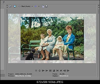

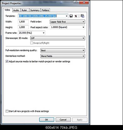

  5. You tend to answer selectively and not telling details at all, just general description what you did, but if you want to solve this, or get confirmation, you need to say actual details and steps what you did, not just one sentence without any numbers in it, numbers are needed!
    You can replace your title in DVD Architect project and create DVD. Thing is, we do not know what you feed DVDArchicet with. You do not want to re-encode un-necesarily again.
    Can you just print this, it takes you a minute:
    -Intermediate from that PSG, resolution, frame rate, field order, format, bitrate (we know it is mpeg2 and 60000kbps)
    -Vegas project properties (resolution, frame rate, aspect ratio, field order)
    -snapshot of your preview window (because your description of what you did in Vegas could be misleading), possibly say what effect you applied
    -what did you export from Vegas for DVD Architect to make Blu-Ray (resolution, format, field order, frame rate, bitrate)

    It is the prview mode that 'jumps wider' .. it could be DAR vs PAR
    As to advice from smrpix- it doesn't work for me due to file size, I will have to come back into Vegas and split into 2 projects.
    However on a 'practical point' it does seem to work .......... without creating a disc I can't compare the.
    The Vegas forum guys are really adamant that you can't do things this way - they insist aspect ratio is different :

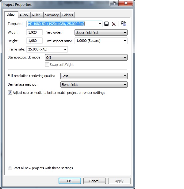

    #2 Vegas project properties (standard European Blu_Ray template
Name:	Project Properties.jpg

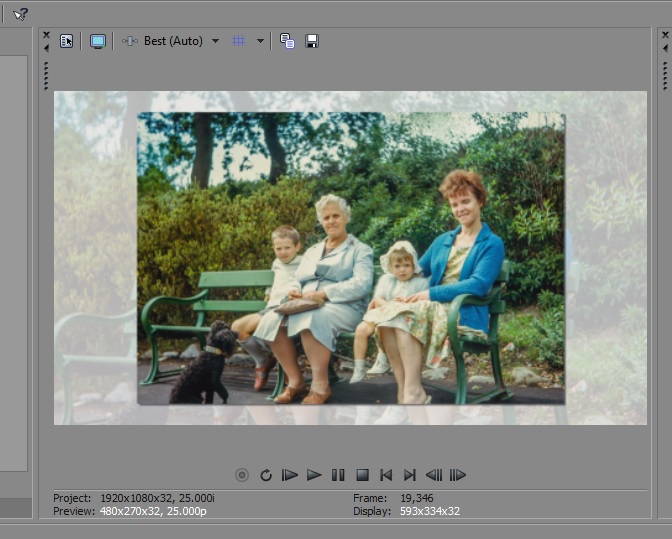

    #3 Snapshot of preview window

  11. I simulated your data, and I got NTSC DVD Architect video stream and Blu-Ray NTSC video stream (only mpeg2, I have old Vegas version only) with the same visual proportion (DAR) while watching it on screen. No cut off with DVD stream. Everything was in the frame. I even tested it loading it in Avisynth, printing image and comparing them. Sure if comparing images, there was different AR (better to say no AR), but during playback flags are properly read for DVD video.
    DVD Architect loaded both streams and in both cases it did not render video again. I did not try to actually render DVD or Blu-Ray, but in File/optimize Disc I got green check mark for both videos. Project properties in DVD Architect has to be set properly so no re-render is happening.
    What you are perhaps confused, I cannot think of the other case now, is that perhaps you try to load that DVD widescreen video stream into Vegas again and THEN Vegas shows its strict Mpeg2 specs magic and it looks like picture suddenly appears "zoomed in" (for NTSC thing, not sure now how it "fixes" for PAL now) a bit on timeline, is that the case?

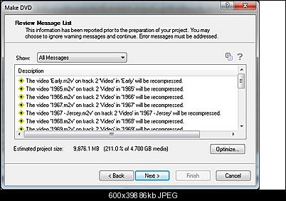

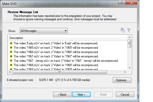

    Just to clarify though - the initial DVDA projcet created with no 'warnings' in preview, however when I then change properties so that Disc type is DVD ... all files then marked as having to be re-compressed and have to be re-compressed:
Name:	DVD recompression warnings.jpg
    It took over 2 Hrs to do that - but it did work.
    What seems to be key though is the assertion that 'you can't just select DVD after a BRD render and have it work' is wrong - it does work.

    I did the renders (BluRay 1920 x 1080 template) in Sony Movie Studio (~'Vegas') creating my input files for DVDA
    Then loaded these into DVDA added menu structure, playlists etc. ....... then used 'Make DVD' option and created a Blu_ray Disc. When you use the 'prepare' step ... it does a pop-up window of any alarms or notifications ...... when I created the Blu_Ray disc .. .no warnings, created fine.
    As per suggestions here - I then went into DVDA properties and changed disc type to DVD .... again the prepare step brings up warnings windows ... which is what I posted in #42 every video & audio track had to be re-compressed.
    It all worked though - just took a few Hrs.
