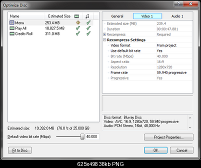

  1. As some of you already know, I am trying my hardest to author a BDMV in DVDA. I am super close and thanks for all the help so far. The last thing that I can't seem to figure out is why DVDA won't accept the video for the animated menu. As you can see from the screen shot below, it accepts the video for the Play All and Credits Roll, but not the Menu, even though I encoded them all with the exact same x264 command.
    x264 --bitrate 27500 --preset veryslow --tune film --bluray-compat --vbv-maxrate 28000 --vbv-bufsize 27500 --level 4.1 --keyint 60 --open-gop --slices 4 --colorprim "bt709" --transfer "bt709" --colormatrix "bt709" --sar 1:1 --pass 1 -o out.264 in.avs
    x264 --bitrate 27500 --preset veryslow --tune film --bluray-compat --vbv-maxrate 28000 --vbv-bufsize 27500 --level 4.1 --keyint 60 --open-gop --slices 4 --colorprim "bt709" --transfer "bt709" --colormatrix "bt709" --sar 1:1 --pass 2 -o out.264 in.avs
    I understand it is only a menu, but it is a heavily composited menu with a lot of keyframed effects, and when I let DVDA encode it, DVDA does a really bad job. So I pulled the m2ts from the test BD-RE to compare DVDA's encode with my encode and below are the differences. But from what I can see, there really aren't any differences. Does anyone have any insight as to why DVDA won't accept my encode? Thanks as always.

    The post-VPro 10 webinar notes article is not on the SCS site any more, but it included the following note.¹
    Q. Why does DVD Architect recompress to finalize the menu in a Blu-ray disc? How can recompression be avoided when burning a BD-R with a menu?
    A. All of the objects that make up the menu have to be combined into a single file. This includes all of the background, button, text, and other graphical elements. This cannot be avoided.
    ¹)link
    (If you click the + (Recompress) in the Optimize Disc dialog, does it give you "reasons for required recompression"?)

    Brilliant! Of course! Why didn't I realize that?? While I drop my video into the menu, I also have several "elements" that allow the viewer to pick and I keyframed those elements to fly in just before the loop point. I should have guessed that they would need to be encoded.
    Thank you so much for pointing that out. I can breathe easier now.
    Now I just need to drop the lossless version of the video into the menu to avoid generational losses. The only problem is the AVI is 1920x1080p29.97. So I guess I need to push it through the Avisynth script at a minimum and rewrite out the AVI. The Avisynth script merely doubles the frame rate to 59.94 and downrezes to 1280x720. Who knows what kind of resizer DVDA uses. I am guessing I can use ffmpeg to re-write out the Lagarith AVI? Something along the lines of:
