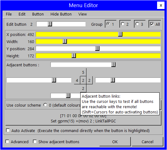

  8. how should I edit (in PGCEdit) the way the highlight moves, as I navigate with the remote control?
    Highligth the menu at the left. Press the Menu icon at top. In the "Menu Buttons" window that pops up rigth click a button. In the "Menu Editor" that pop up use the sliders for "Adjacent buttons" (I use DVDRemake for this)
Name:	Screenshot - 12_10_2015 , 9_05_07 PM.png

  9. OMG!! Didn't know it was that easy!! Thanks, man!!! (again)
