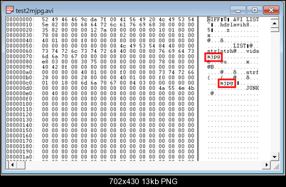

  2. Try setting the fourcc to mjpg instead of jpeg. Attached is your test2.avi with the fourcc changed.

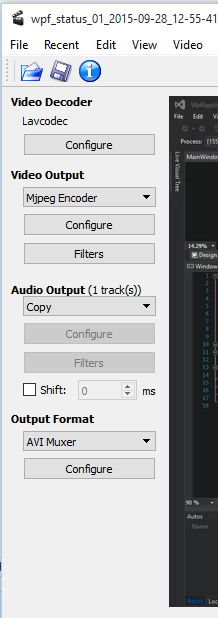

    Thanks for replying! I sent the file on to them to test out. Can you recommend a video converter to encode with the proper settings? As I stated before we are using Avidemux and I can't find any option to set the fourcc to mjpg. Inside of the tool we use I set the Video output to Mjpeg encoder and format to avi.
  4. I used a hex editor to change the fourcc in your file:
    The marked locations previous read "jpeg". The exactly location may vary a little depending on the program used. But it will always be near the start of the video in AVI files.
    You can try using VirtualDub with the ffdshow encoder in MJPG mode to create new files. VirtualDub also has a built in hex editor you can use to modify files you've made already -- or to test different fourcc codes. Some players are case sensitive so you might need to use "MJPG" instead of "mjpg". Some other possible fourcc codes for motion jpeg: LJPG, MJLS, AVRN, MJPA, SP5X, AMVV.
