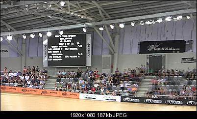

  12. Yes, you can tell the video was motion interpolated to twice the original frame rate -- watch the lights and vertical lines on the wall starting around frame 125. In every other frame (the frames created by MVTools) you can see distortions that MVTools generated when it analyzes the motion incorrectly:

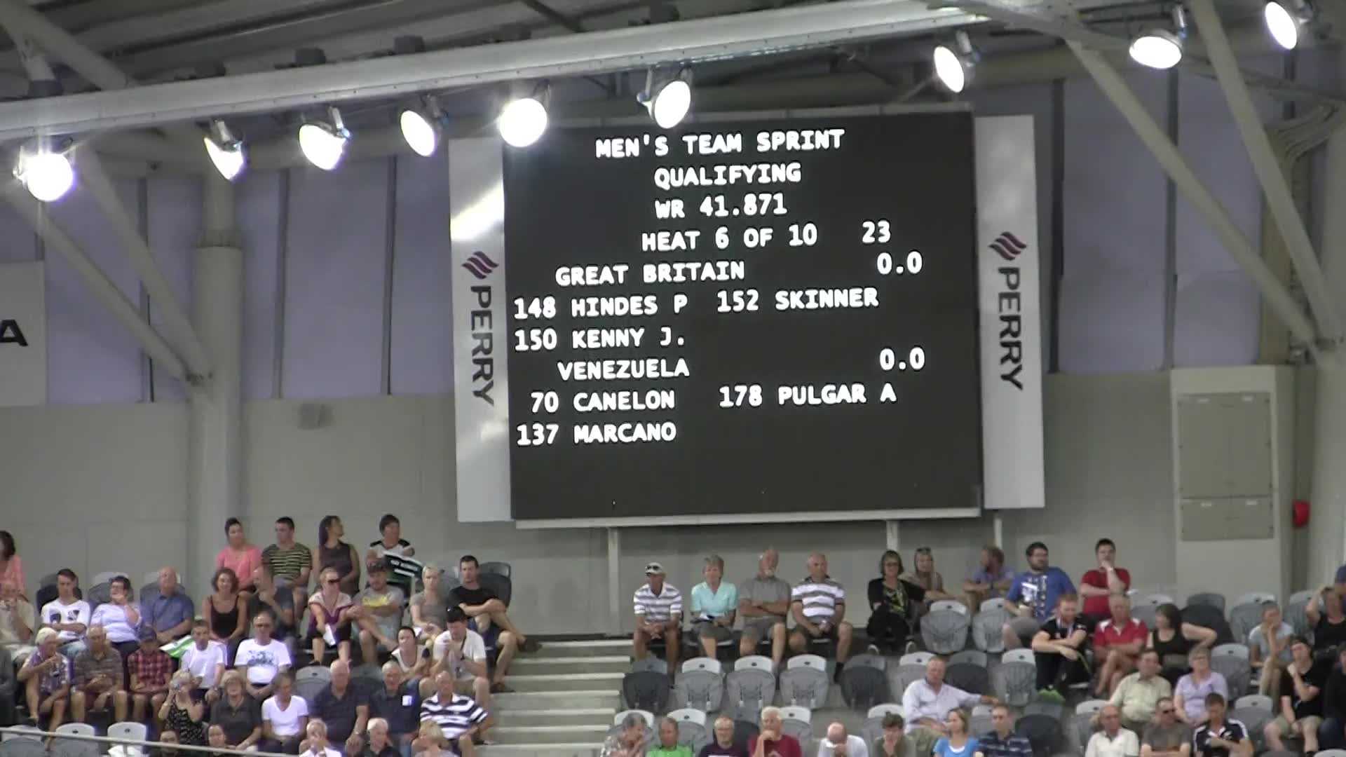

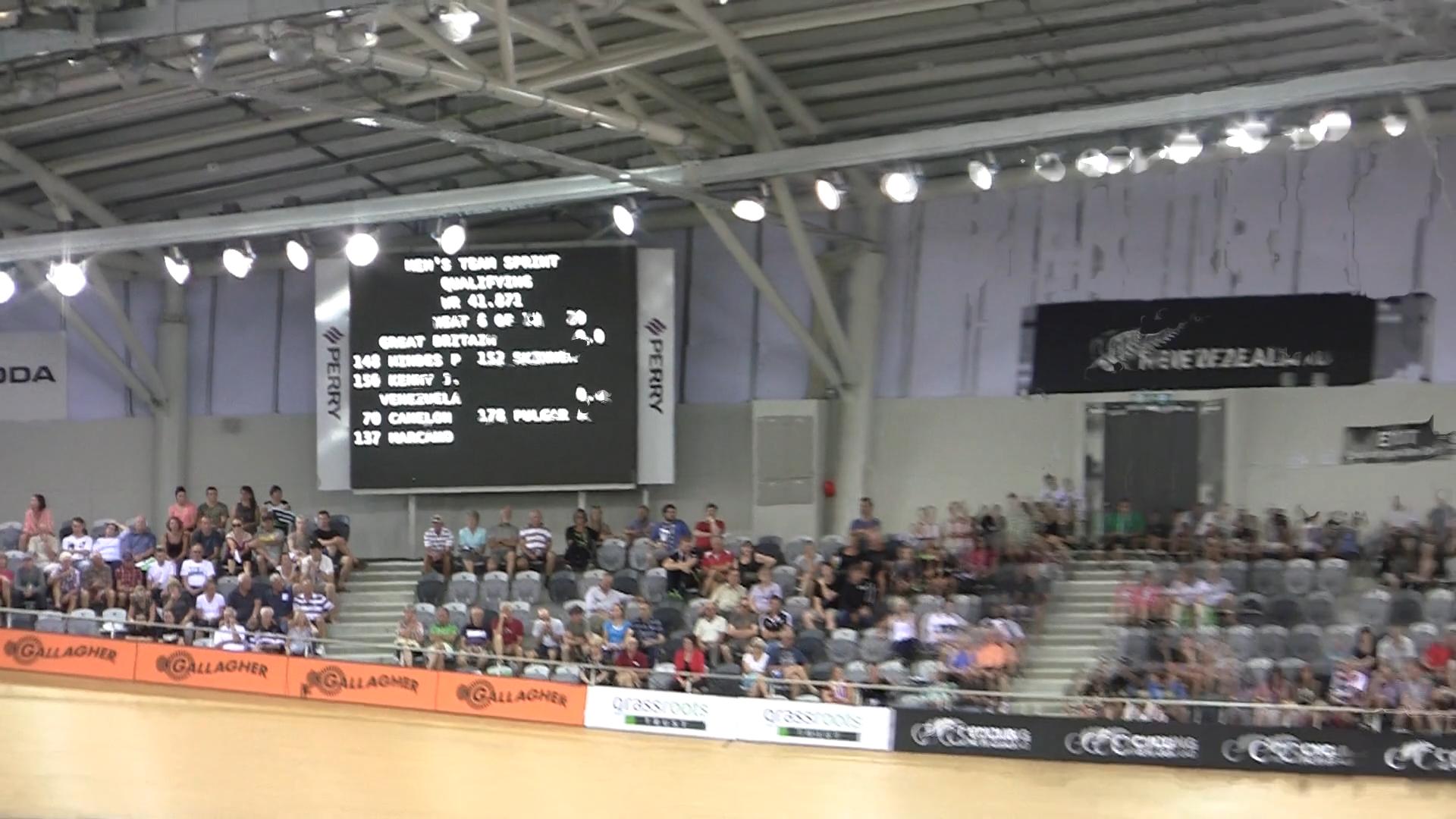

  18. Hm,
    that's an interesting question. From my understanding "yadif=1" should use a motion weighted algorithm to turn 50i material into true 50p.
    I've just created an output of the first 6 frames of "source_sample2.mp4". See the attachment.
    Please note that filesize is different for each frame.
    Regards
    fornit
