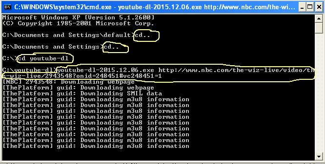

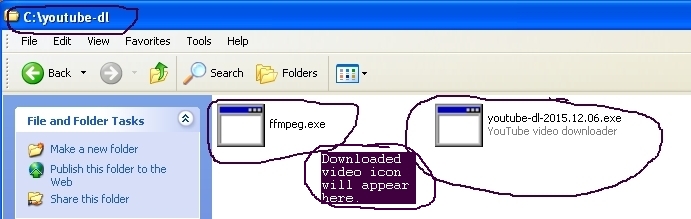

    I was able to download the video ( given the above link that Biezom posted). I am providing the following explanation so that others can follow.
    1) I made a yellow folder on the c drive and named it:
    youtube-dl
    2) Inside the folder I put:
    ffmpeg.exe
    and
    youtube-dl-2015.12.06.exe
    (See first screenshot)
    3)I went to command line (start> run>cmd) and typed in or pasted the stuff in yellow circles.
    I hit the enter button at the end of each line (See second screenshot.) After a while the completed video appeared in the yellow folder (youtube-dl). Note: I did not download or install anything called "Python interpreter".

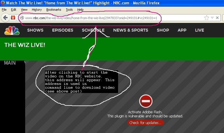

  5. Above post question #1 solved here.
    Go to nbc.com and click on
    Full Episodes
    Then choose
    The Wiz Live!
    from bottom of menu.
    Click to start video to see the needed URL
    See screenshot.

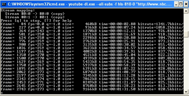

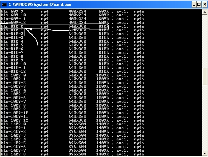

  6. Question #2 and #3 answered here (how to choose bit rate/resolution and download subtitles for nbc.com TV shows).
    To get a list of possible bitrate/resolutions, use the following command (youtube-dl.exe -F "URL of show that you want"). For example:
    youtube-dl.exe -F "http://www.nbc.com/the-wiz-live/video/the-wiz-live/2943548?onid=248451#vc248451=1"
    The -F inserted before the URL will give a list and you can choose a bit rate/resolution (see screenshot, white circle). Here I chose a resolution/bit rate of 640x360. Then you copy the spec (see white arrow):
    hls-810-0
    and put that in the command line. For example:
    youtube-dl.exe -f hls-810-0 "http://www.nbc.com/the-wiz-live/video/the-wiz-live/2943548?onid=248451#vc248451=1"
    This will download the video in 640x360 resolution.
    If you also want to download the subtitles, you can add:
    --all-subs
    so that you will have, for example:
    youtube-dl.exe --all-subs -f hls-810-0 "http://www.nbc.com/the-wiz-live/video/the-wiz-live/2943548?onid=248451#vc248451=1"
    This will download the video with 640x360 resolution and also the subtitles (TTML) in a separate file. The subtitle file can be converted to srt with Subtitle Edit (browse for "all files" to input the TTML file into Subtitle Edit and save as srt.
    If all goes well, the two files will start downloading (see second screenshot) and appear in the youtube-dl folder.
    Note: I used youtube-dl 2015.12.13 (December 13, 2015) for all this to work. Previous version of youtube-dl didn't seem to work on nbc.com anymore.
