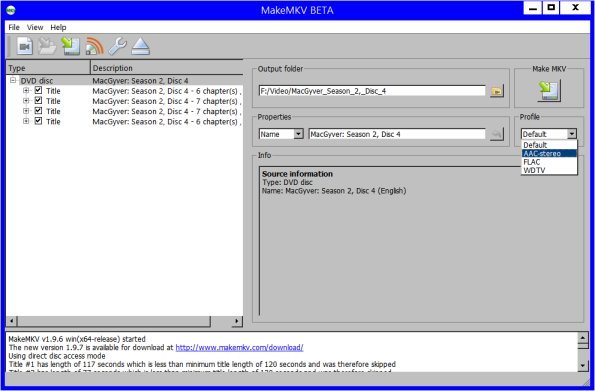

  7. If you're using MakeMKV why not have it do the audio encoding:

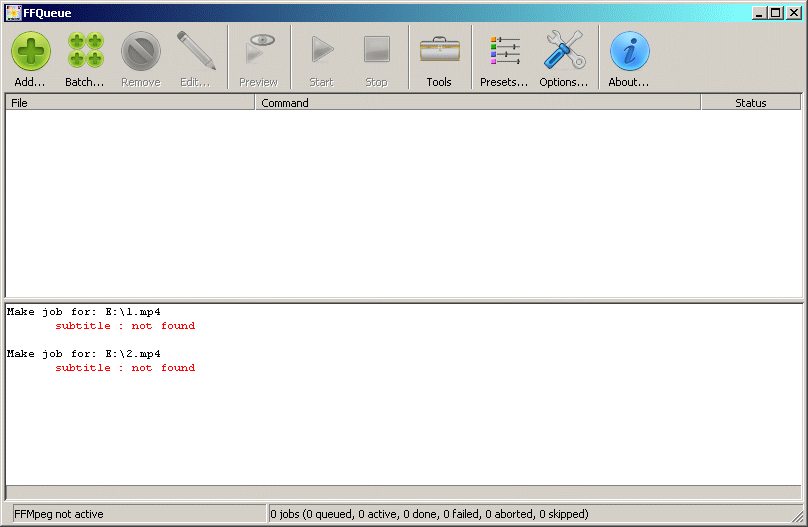

  10. For me, FFQueue wouldn't add files without subtitles to the queue in batch mode if subtitles were selected in the "Batch Make" window. The result was this:
    Unless in your case it's doing something silly like converting chapters to subtitles if it doesn't find a subtitle file. I haven't tested that.
