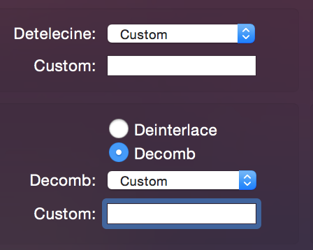

    Another quick question: What are the "custom" parameters for Detelecine and Decomb/Deinterlace? What do they do and what do I enter in them?

  10. Originally Posted by Jag12 View Post
    Something like this, although it's old and probably outdated. Maybe Google "Mencoder de-interlacing" or "Mencoder command line".
    https://trac.handbrake.fr/wiki/Decomb#options
