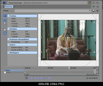

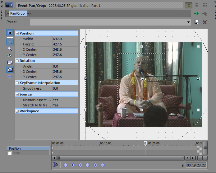

    I will also add a Vegas cropped image (that would be nice to do cropping in Vegas, easy to crop there and position the subject to the center), if that is of any help.

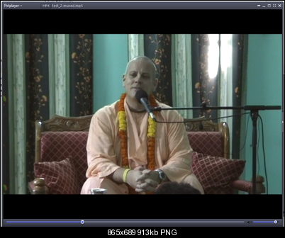

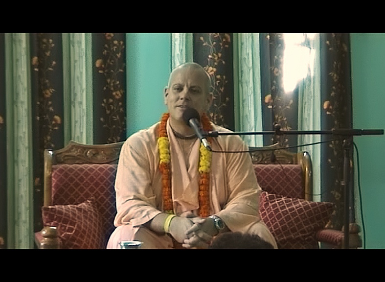

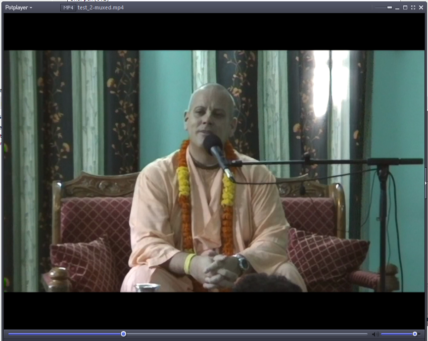

    Yes, that's what I want but something is wrong here. This is what I'm feeding into Megui:
    And this what comes out according to the script:
    I just want to remove the letterbox.
    EDIT: The script is proper, I missed the cropping in the script. Now it's ok.

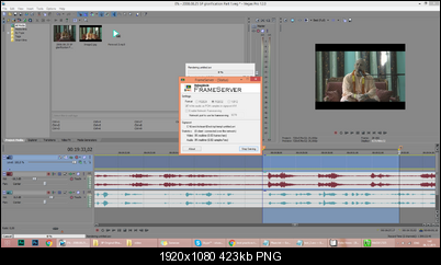

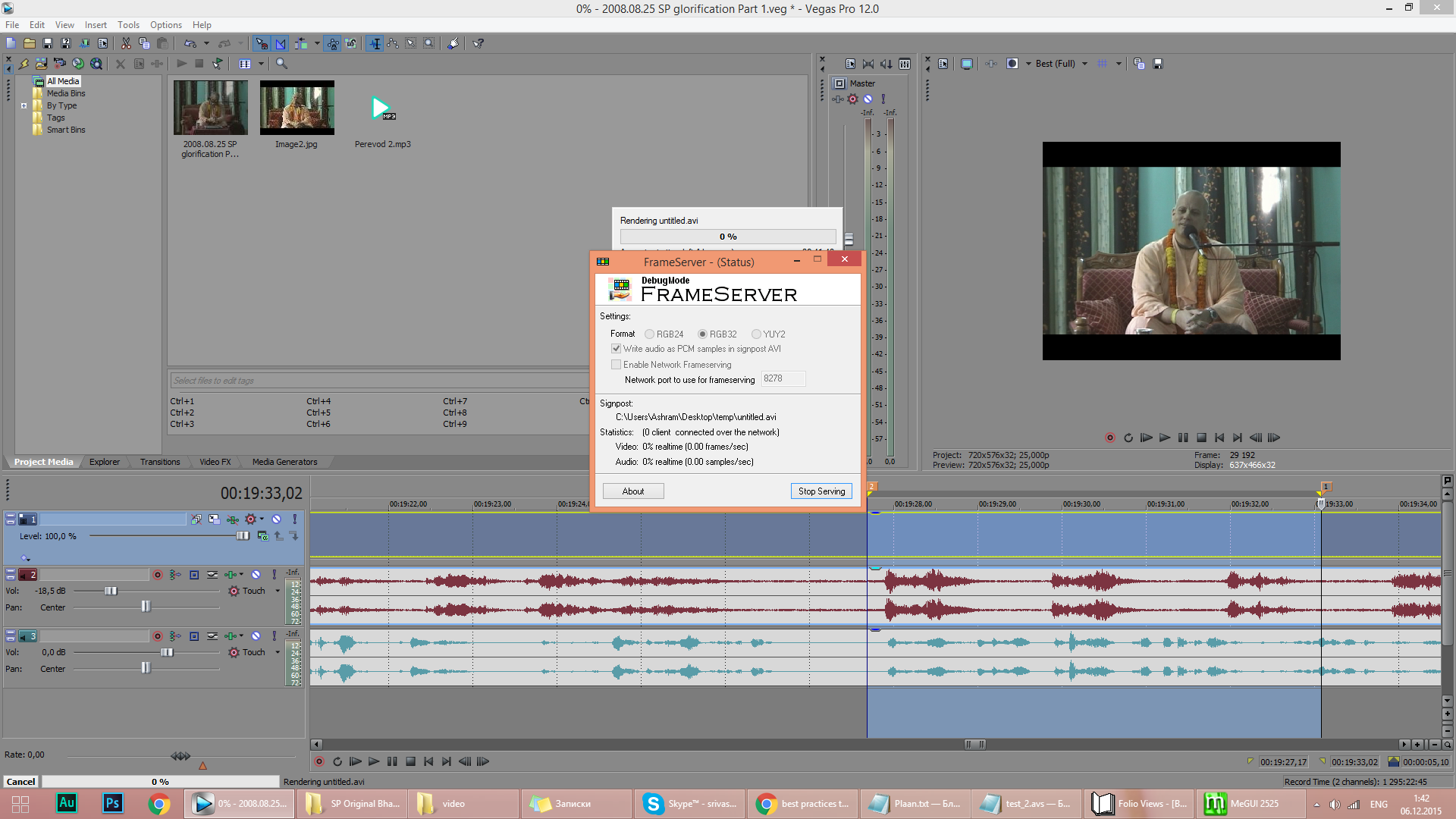

    And just for reference, if that thread might be useful for someone, this is the actual script to get it working as per frameserving from vegas (that means an avi source and required YV12 colorspace).
    AVISource("C:\Users\Ashram\Desktop\temp\untitled.a vi", audio=false).AssumeFPS(25,1)
    ConvertToYV12(matrix="PC.709", interlaced=false)
    dehalo_alpha(rx=2.5, ry=2.5)
    TemporalDegrain(SAD1=200, SAD2=150, sigma=8)
    MergeChroma(last, aWarpSharp(depth=5))
    ChromaShift(c=2)
    Sharpen(0.2)
    nnedi3_rpow2(2, cshift="Spline36Resize", fwidth=1280, fheight=720)
    Sharpen(0.2)
    nnedi3_rpow2(2, cshift="Spline36Resize", fwidth=1920, fheight=1080)
    Sharpen(0.2)
  12. Not sure if that is correct approach, Jagabo fixes everything in Avisynth, to get
    1440x1080 or 1920x1080 (with Crop(0,72,-0,-72) ) , so he should frame serve original clip, 720x576, he might need to interpret his footage to 4:3 PAL video, right click his clip/properties/Media Tab and set Pixel Aspect Ratio to PAL DV,
    but in his sample, video is flagged as progressive and it seems to be progressive, but he frame serves interlaced video, judging by his script. Jagabo does not deinterlace in his script. So this might need to be straighten up in his Vegas project as well. Vegas should have project properties of the clip, they have to be the same, clip properties (PAL DV but progressive) and projects properties (PAL DV but progressive), if frame serving, this is important.
    Maybe if he fixes his project settings, his clip in Vegas preview window would look correct without interpreting his footage.
    EDIT: sorrry I did not talk to you (Srivas) directly, I thought smrpix input was last in this thread
    Nov 2007
    I'm here
    Al, thanks for noticing. I already fixed that in the process. I will edit the above post to make it less confusive. The file is progressive and this is how it's set in the final script.
    And the other point is valid also. Right now cropping is done twice, right? I should have had to post the original clip but I thought it might be easier for me to do the initial cropping in Vegas and just remove the letterboxing in avisynth. But then again, if that would affect the final material, then I will adjust to the learning curve...
  14. Do not crop in Vegas, because you are frame serving project properties, you'd need to fix even project properties to those values as smrpix suggested, but that would mean Vegas got his hands on video (DV is not square pixel) , and then Avisynth would do it again anyway, I'd just set project as clip (PAL DV but field order changed to progressive) and then use these lines in Avisynth:
    Crop(0,72,-0,-72)
  15. Originally Posted by Srivas View Post
    Technically, you're not really cropping in Vegas right now, you're just adding black bars to the image which need to be cropped out afterwards. That's why I suggested you create your timeline as a 16:9 composition and frameserve an actual (cropped)16:9 signal.
  16. It looks that he had those black bars in Vegas' preview window because his project properties were set wrong. It should be ok now.

    Ok, I got your points. You see, I also did some initial cropping in Vegas. This is how it looks like:
    I wanted to position the subject in the center. How can you do the same in avisynth?
  18. do not crop in Vegas but in Avisynth instead of :
    Crop(0,72,-0,-72)
    use something like this:
    Crop(0,36,-0,-108)
    If you'd need to crop differently in every clip in Vegas, THEN you'd need to use Vegas for it, like you just did, keep the same project properties, that is what smprix perhaps think, that would introduce those black borders in Vegas. You'd use the same script in Avisynth (cutting those black borders) But you'd introduce one more resize (bicubic or whatever Vegas uses) in your whole process. And there is one more thing, your video is not square pixel, so you'd cut certain number of pixels that keep real aspect ratio at the end, that is why it is better to leave it all to avisynth. Well in PAL land aspect ratio screw up is not that visible as in NTSC land, so ....

    Thanks! Just did a comparison and the quality is slightly better also. That just confirms your point.
