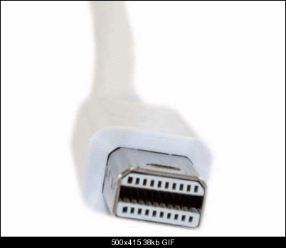

    This is what the cable end that goes into the camera looks like with rgb at the end going to the zeebox. The monitor is just a DELL computer moniotor with a vga input and power cord.
    The "Splitting" of the signal would need to be before it enters the Zeebox.
