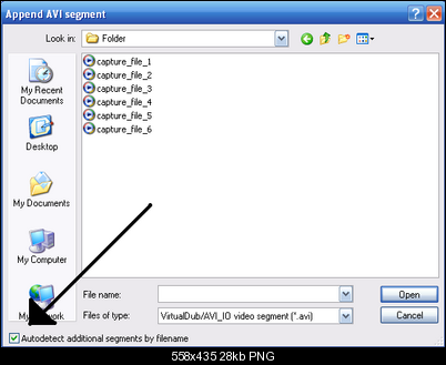

    The File > Open Video File > File > Append AVI Segment is EXACTLY WHAT I DID! But I thought the guide on joining said to open the first cut up that way and then add the following cuts with File > Append AVI Segment Was it suppose to be just adding all cuts with File> Append AVI Segment then?
  13. If your source is a single file all you need to do is File -> Open Video File. If your source is multiple AVI files that you want to join together you use File -> Open Video File to open the first, the File -> Append AVI Segment to add each of the additional files. If your AVI file names are number sequentially you only have to append the first one, the rest are automatically appended. So if you have:

    Open FILE0001.AVI, then Append FILE0002.AVI. FILE0003.AVI and FILE0004.AVI will be be appended automatically along with FILE00002.AVI.

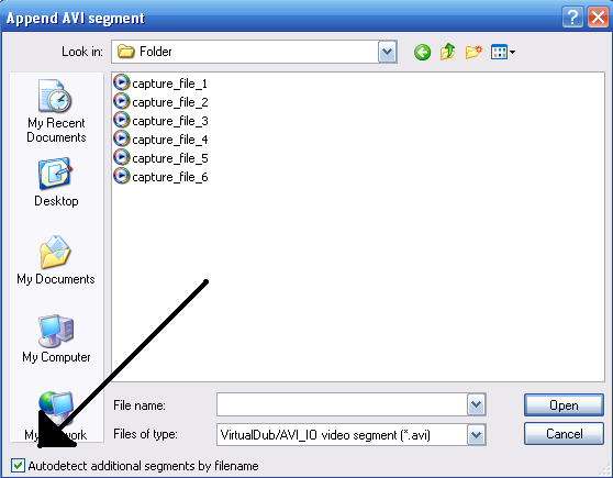

  17. Member PuzZLeR's Avatar
    Oct 2006
    Toronto Canada
    Originally Posted by mulliganman
    I looked back this morning at my "joining" of the edits and it appears I included two copies of the video into the final edited version. Do you have any idea what I may have done wrong? I figure it is some sort of newbie mistake with the software so I am hoping a more experienced user like yourself could help with this.
    Some explanations followed before I was able to get back to this thread.
    But perhaps, this can also help. Look at the arrow.
