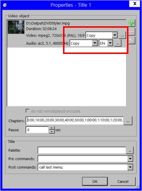

    It seems like I don't have the option to "do not remultiplex/transcode" in DVDStyler - I found out this is because the mpg does not have "nav packets" - is there an easy way I can add nav packets to this so that I can author in DVD Styler so it gives me the option not to remultiplex/transcode?
  10. is there an easy way I can add nav packets to this
    Why would you do that? The reason you don't have the option "do not remultiplex/transcode" is that remultiplexing is needed. DVDStyler uses ffmpeg for this. You could do the same thing manually (with the risk of mistakes) but it'll be the same process and take the same time.
    What you want is to maintain quality, ie using stream copy which is something different and is done by "Copy" in DVDStyler.

    Re-multiplexing does not change anything. It must be done whenever video and audio are moved to a different type of container file or edited, so both VOB2MPG and Mpg2Cut2 have already done it. Authoring a DVD from an mpg also requires copying your audio and video to one or more VOB files, which are a different type of container.
    Transcoding would reduce quality, however DVDStyler should not do that unless the video that you want to author is too large to fit on the DVD media (DVD 5?) that you plan to use.
  14. So the remultiplex/transcode process won't affect my quality?
    No. The "Copy" option in the image in post #10 means that the original video/audio is used. Not using "do not remultiplex/transcode" is just to multiplex to add the "nav packets".

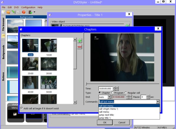

    But say when you used a button to select song 2 what happened when it finished playing? Did it continue with song 3 or did you return to the menu? If you don't use any cell command it'll continue with song 3. You may then use an unconditional cell command as "call last menu;" in which case you'll always return to the calling menu preventing you from playing the concert as a whole. With a conditional cell statment you like "if(g5==g6) call last menu;" you can have a button to play song 2 on it's own and another to play the whole concert.
    The unconditional statment is shown below
