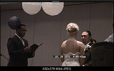

    For MTS, I usually use the CMD Binary join version which retains the PGS subtitles as well.
    copy /b "C:\Users\Bud\Desktop\Old Projects\Wedding\00165.mts" + "C:\Users\Bud\Desktop\Old Projects\Wedding\00166.mts" "C:\Users\Bud\Desktop\Old Projects\Wedding\00165_Joined_3.mts"
Name:	ScreenHunter_181 Nov. 30 22.44.jpg

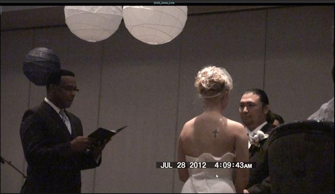

  8. Originally Posted by Budman1 View Post
    The output plays properly in some software --Premiere Pro CC 2015, ffmpeg, not so well in others --Avid, VirtualDub, MPC-HC ,TMPGenc VMW5.
  9. Member Budman1's Avatar
    Jul 2012
    NORTHWEST ILLINOIS, USA
    The results of smrpix are correct, some play others may have problems joined with the binary method. My results were:
    Potplayer Plays Ok WITH subtitles
    VLC plays ok WITH subtitle
    FFMpeg plays ok but WITHOUT subtitles
    GOM Plays ok but WITHOUT subtitles
    Vitualdub Plays ok but WITHOUT subtitles
    WMP plays ok but WITHOUT subtitles
    All the above installed players seem to play the joined video fine but some do not show subtitles even though they are shown in the joined video with MediaInfo, however they don't seem to show subtitles from the unjoined videos with (PGS) subtitles either.

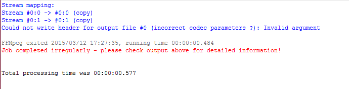

    Thank you for your explicit clarification, but it fails!!!
    I am running Windows 7 64-bit and have downloaded ffmpeg-20151130-git-7b11eea-win64-static and FFQueue_1_6_45 and I have gone through what you have told, but it always fails!!!
    Jul 2014
    Denmark
    What is the error? The console must display some details about it..
    I'm the developer behind FFQueue. My posts might reflect this! ;-)
  16. Originally Posted by TorBru View Post
    This is the error, and the status is FAILED
    [Attachment 34679 - Click to enlarge]

    What destination file name do you specify in FFQueue? If you specify *.mts the error might be that FFmpeg cannot find suitable a muxer. The default, suggested format in FFQueue is *.mp4 - which is not usefull for the task. Please try with *.mkv which is the most versatile format and try again.
  20. Originally Posted by TorBru View Post
    As you recommended I ticked perform simple concatenation so there was no need for choosing the preset, but I have also tried choosing a preset such as wmv or mpeg but again no successful result. There was no .mkv by the way.

    You got that one wrong.. In the "Destination" group you must specify an output "File name" (the file where the sources are concatenated to). You should make sure that the file name specified uses the extension mkv (by default mp4 is applied by ffq). The file name could be something like "C:\>MyVids\MergedVideo.mkv".
