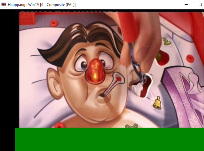

    I'm trying to capture my television with composite cables through a USB dongle mentioned in the title.
    However, for some strange reason, there's a huge, green bar at the bottom of the screen for no reason at all.
    This happens whenever I connect the USB to the computer and try to stream live TV.
    Any tips?
    Here's a screenshot of the problem:

    PAL TVs can display PAL60 -- that's a signal with NTSC timing but a PAL chroma subcarrier. Trying to capture that with PAL timing can produce something like what you're seeing, about 480 lines of picture in the 576 line frame. It's usually VHS decks that output PAL60 -- when playing NTSC tapes.
  10. I followed your advice, Jagabo, and managed to get rid of the green bar by switching to NTSC. But, it cropped my image and basicly removed the area where the green bar was. Now it's missing 20% of the screen. Not sure what to do now.

  12. Originally Posted by Keitaro004 View Post
    If you watch the tape on TV is there 20 percent more picture at the bottom? Or is the same picture squeezed into the 480 line capture?
    And what exactly are you capturing from? A VHS deck? Cable? Satellite? Can you set that source device to PAL output instead of PAL60 or NTSC?

  13. I'm capturing from a digital TV decoder (cable). It's basically Live-TV, only through a box with selectable channels.
    I've connected it to my USB capture device by composite cables.
    Yeah, there's 20% more picture on my TV. I've compared them several times.
    I can't do anything with any of the settings on my device. I suppose it automatically adjusts to the required resolution.
    My computers' max resolution is 1366x768, but that shouldn't really matter when I'm capturing SD video.
    If it's worth mentioning, the device would show the whole picture on my stationary PC for some reason. I stopped using it, as the computer disturbs the capture (with several transparent lines rolling downwards) and has an annoying buzz sound as I record.
    I'm now using my laptop, and the only problem I have is the cropped picture.

  15. Originally Posted by Keitaro004 View Post
    the device would show the whole picture on my stationary PC... I'm now using my laptop, and the only problem I have is the cropped picture.
    That would indicate a driver or configuration problem. Or OS compatibility issue. Go back to capturing PAL and try looking for newer or older drivers, reinstalling the drivers and software, and check all the settings.

  24. Hello again. I managed to fix the crop by downloading older drivers, which worked for some reason... even though I'm on a Windows 10. However, now there's this annoying high pitched sound in the background. It's very noticable in more quiet scenes. Tried to fix this by lowering the volume of the recorded video, but to no avail... It sounds kind of like when an old television set is turned on.
