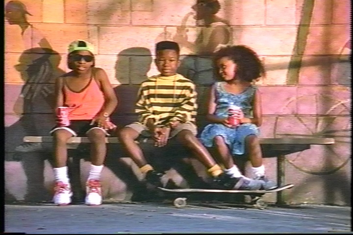

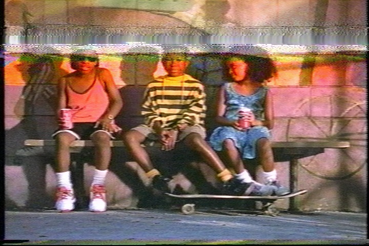

    The first tape I tried was cassette 1 of Titanic (it's expendable). The second tape I tried was Home Alone. I played two more, all is well.
    Put that first one back in, and this time around the automatic tracking couldn't handle it. So I tried Home Alone again. Same deal, and this time I attempted manual tracking but no position would clear it up.
ID:	34621 Click image for larger version

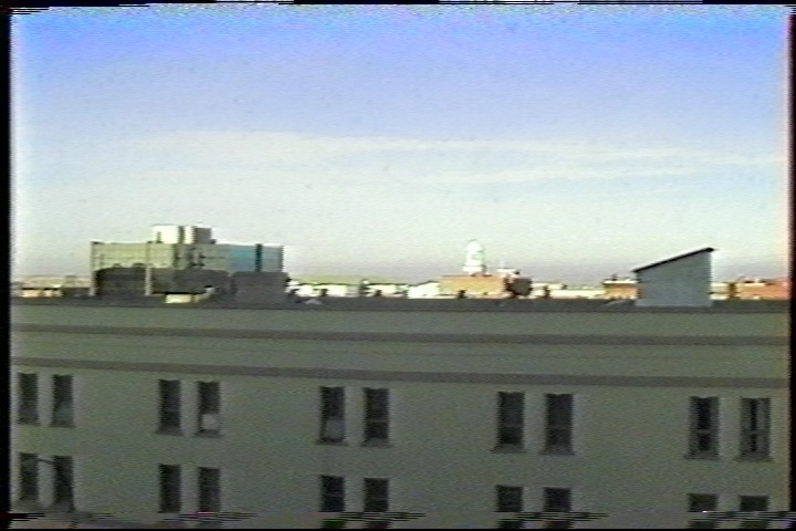

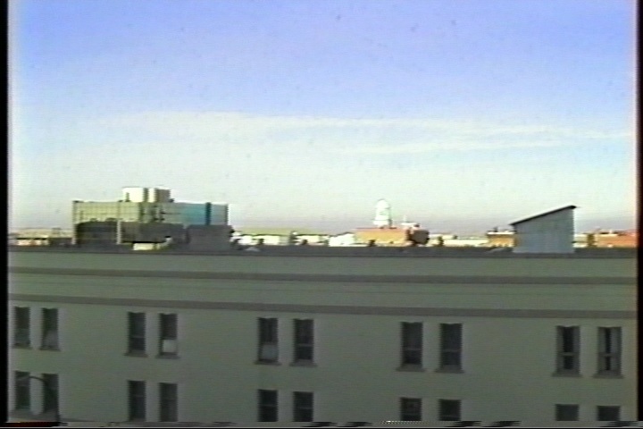

    Camcorder footage that played fine the first time:
ID:	34619 Click image for larger version
    What the hell?

    Tried the camcorder tape tonight in a crummy regular JVC VCR and it still plays without issue in that one.
Name:	Downtown - JVC HR-J693U, EDIT =CVBS= JVC HM-DH5U HDMI.jpg
