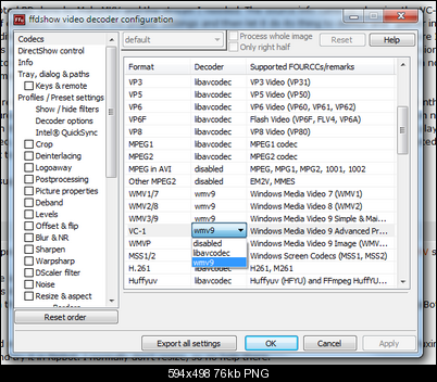

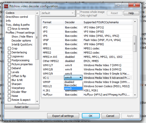

  3. 1) Run ripbot264
    2) change decoder for VC-1 in FFDShow . Select wmv9. However I'm not sure if win10 has this decoder installed by default.

  4. I've done this, both the wmv9 and libavcodec options and the only thing that changes is that the blank frame changes from gray to green, otherwise no change. Any other ideas? When RipBot264 does appear to be processing the video, I do see the Haali and FFDshow icons appear in the system tray, and the FFDshow icon says the input is WVC1 and output is YV12. The demux phase does properly generate a video-only MKV.
