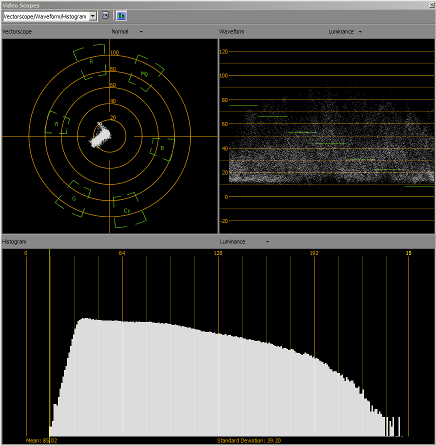

    @Graay, could you post a short 4:3 clip converted by Cloner AP? Thanks!
  23. Member
    Nov 2023
    Christchurch NZ
    https://files.videohelp.com/u/308200/Birdy.mp4
    Taken on an analogue Sony Handycam on LP speed 35 years ago converted with Cloner AP using 4:3
  24. Banned
    Nov 2022
    Either @12voltvids was wrong, or he has a better version than yours.
    • You are in NZ, was your source 30 fps? If yes, why 60.00 fps instead of 59.94 fps? If no, why 60.00 fps instead of 50 fps?
    • The 4:3 frame is not stretched to HD frame - good, but @12voltvids said that his unit generates true 4:3 frame - yours does not, it letterboxes 4:3 content inside HD frame.
    • Cropped to 960x720 it shows black areas on the left and on the right, meaning that the box treats the whole 720-wide frame as 4:3, which is generally wrong, only the 704-wide portion has 4:3 proportions, so your picture is teeny-tiny squished horizontally.
    • The good thing: correct video levels, should look ok when uploaded to YouTube. But will suck to watch on a smartphone with vertical orientation, will have black sides.

Name:	Birdie histogram.png
    Does that apply to 8mm? I thought that issue (dubious IMO) was only related to captured VHS broadcast video designed for CRTs.
    Overall, birdy looks pretty good to me. I'd crop that gunk off the bottom though.
    Also, as Bwaak points out, the burnt-in black sides bars are unnecessary. They could mess with the TV display but definitely are annoying on a PC and would show up on YT. On a phone in portrait, they will reduce the size of the actual image.

    What an expert!
    I am not an expert - just posted here as I thought it might help the OP.
    I obliged to your request for a clip knowing this expert analysis was forthcoming but here I am, still delighted with the captured memories from so long ago, a lot of which were at LP speed & terrible quality, often out of focus on my then, new camera.
    There are plenty of settings on the Cloner AP I just simply select HDMI, 4:3 & 720P (720P is the lowest default). I think it automatically does the 60 frames by default.
    Finally, a rhetorical question, what are you comparing the Cloner AP to (being that all things are relative) we are not talking about a Professional set up here costing thousands?
  27. Banned
    Nov 2022
    Were you digitizing a PAL tape? The result should be 50p, not 60p. Can you explicitly choose 50 fps rate? Can you choose for the box to match the input rate?
    Since it is a rhetorical question, I don't need to answer... but I will. I am not comparing it to anything. I am noting some peculiarities, which Cloner Alliance could have addressed long ago to make it a better device, and maybe it did, you just have an older device.
    For $180 in the U.S. I don't feel like experimenting myself, hence I am asking others for their experience. I already have a similar box, which I bought a while ago for about $60 (on sale for $30 now, frankly I think it's a bargain despite the limitations), feel free to watch a review on YouTube. I would not mind getting a better one if it has the issues addressed. But looking at your file, yours does not seem to do better unless you made a mistake configuring it. Actually, it does: black level is correct.
    If there are indeed a plenty of settings, can you specify output frame rate, like 50 fps? Can you force it to generate true 4:3 frame, like 960x720 or 1440x1080 (with square pixels), or is it always 16:9? Broadcast HD must be 16:9, so if your content has different proportions, it must be contained within a 16:9 frame with some black bars. But this is broadcast, if you make files for watching on a computer or uploading to youtube, you can have any aspect ratio you want.
    So, can you check the frame size and frame rate options, please? Much obliged! And thanks for the sample!
